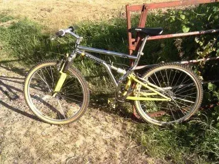

my x1 is a small frame with yellow rear triangle and yellow rock shocks.....and yellow wellgo pedals. i'm in two minds about the overkill of yellow.
i've got hold of some rc36 evo's to put on it at some point.... :lol:

I do love the look in yellow . . . . Im so jealous you've got a set of RC36's . . . But i do have Justbackdated sourceing me a set . . . . Can you tell me what braking and grearing system you using mine are both Shimano Deore XT?
I like the fork and triangle colour match - might try that on mine when I *eventually* get round to rebuilding it :roll:
