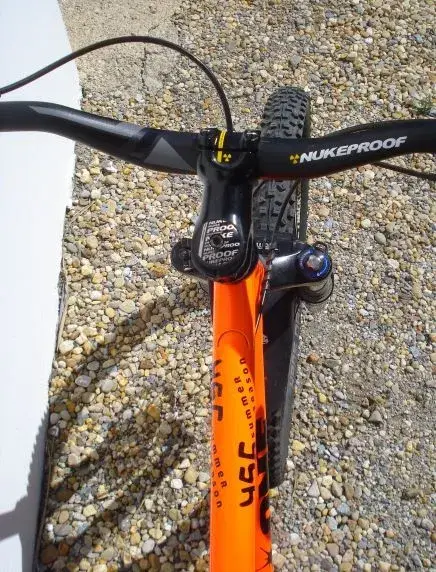

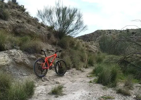

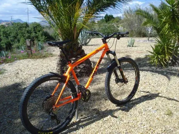

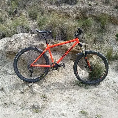

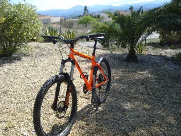

On Ones are a bit Marmite on this site but as this is my third I have to admit to being a fan. Visiting my LBS to use their compressor I saw this dayglo orange frame buried under a pile of old tyres and buckled wheels and a deal was struck. Not as good as a tip find but I'm still very pleased. All my frames are usually 16" but with the sloping top tube I chanced an 18" to get the benefit of the longer top tube.
How does it ride? I've read that it's a great bike for pi$$ing about on and can't think of anything better to add although it wouldn't be my first choice for crossing maps.
Build list
Forks: Revelation U turn set to 150mm
Front Wheel: Hope laced to Sun Singletrack Rim
Rear Wheel: 3 zeoros six laced to SOS rim
Tyres: Front Hans Dampf 2.35 Rear Maxxis Minion SS 2.3
Joes tubeless kit with home brew sealant.
DriveTrain: Race Face Atlas, with RF bash guard and
RF NW 30T chainring, XT chain, 11 46 ten speed
Sun Race cassette, SLX 11 speed R Mech and Zee
shifter.
Brakes: Shimano Non Series, 180 Magura rotor (F) 160
Avid(R).
Finishing Kit: Thomson Elite, Nukeproof Warhead 760 bars, 70mm
stem & top cap. Rock Bros saddle with Fire Eye clamp.
On One grips and BBB headset. DMR V8's.
