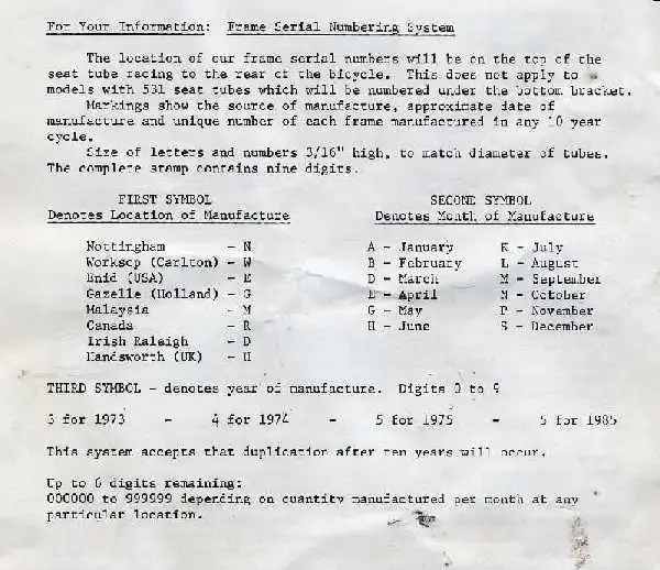

OldTel":28h3d7pq said:
Hi,
this may help, Terry
Interesting...but doesn't help in this case it is pre (Worksop) closure.
So could for some be misleading, if they did not know Worksop closed in 1980.
Very useful would be a similiar document for the 1980s. Anyhow it fails to tally with my"W"prefixed Lightweight Unit bicycle.

My 1982 Raleigh had top of the top tube brake cable brazings and under-bracket cable stops but band-on gear levers and bosses for a single bottle. Certainly by 1989 there would have been braze-ons for gear levers and two bottles. Also weren't they routing the rear brake cable on the lower left side of the top tube then? If not for Worksop closing in 1980 your serial number would mean a 1981 frame which seems to fit the visual appearance. It doesn't look like 1971.
Far be it from me to dispute RK's facts but this site states that Worksop closed in 1981 and that Raleigh carried on using the W prefix even then.
http://www.carltoncycles.me.uk/details/dating.htm
