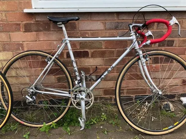

Alloy Competition:
Shimano 600 Arabesque apart from brakes which are the next generation Shimano 600.
Wheels are 36/36 Mavic 500 hubs and Campagnolo Record Pave rims fitted with 27mm Veloflex Vlaanderen tubs (these are fantastic by the way).

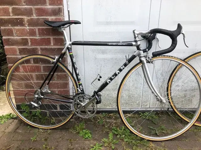

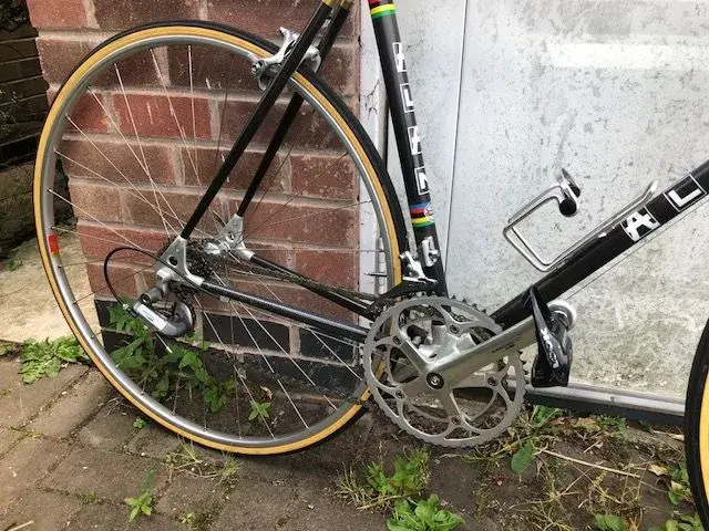

Record Carbonio:
Shimano 600 Tricolour apart from brakes which are single pivot Dura Ace calipers. I have also fitted a TA AXIX titanium BB to this one.
Wheels are 28/28 Mavic 500 hubs with Mavic Argent 10 rims and Veloflex Sprinter tubs. Very light but they don't feel as indestructible as the wheels on the alloy bike.

I must admit I am also not sure if the carbon tubes were screwed and glued like the alloy ones. I think the carbon frame is a little stiffer than the alloy competition frame, but with the lightweight wheels fitted to my carbon bike, it feels really whippy compared to the alloy bike, which has much more robust 36 spoke wheels. So wheel choice has a lot to do with the overall feel of the bike. I do like how my carbon bike feels though, it is probably around 18 pounds in weight and feels really nice, especially on climbs.
