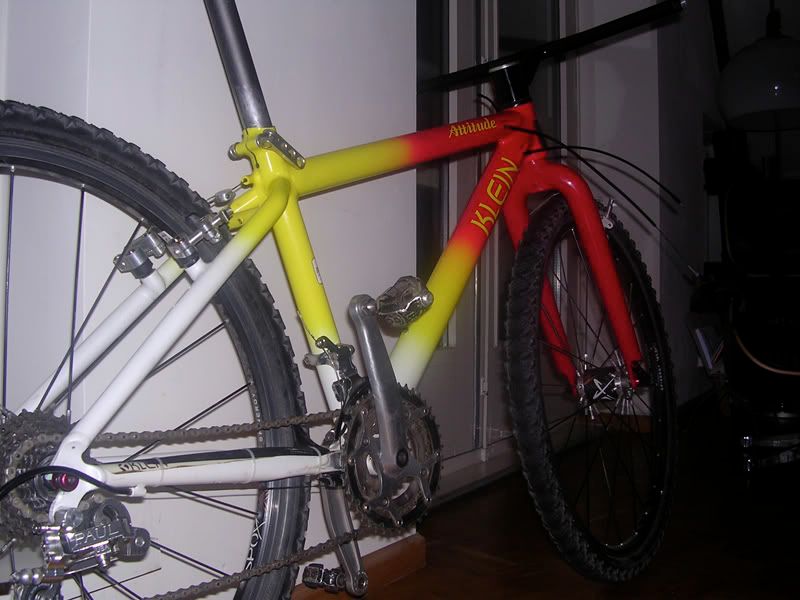

Vbrakes won't work without the Klein V-daptor or drilling the top tube cable outlet larger so you can run the cable housing to the inlet. i wouldnt do that on such a nice condition frame. cantis are powerful enough on the rear.
and take care that the seat post is inserted deep enough. ideally it should end 5 centimeters below bottom of the top tube.

you are right,..I had to drill out the Pinnicle frame to use the v-brakes,..don't want to do that again,..
for now I will install the Onza brakes and will start the search for some nice Paul canti's.

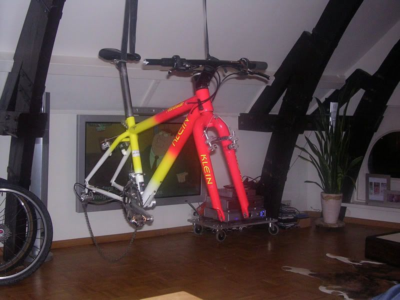

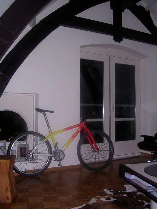

I have started building the bike.
It is not with the components I would like to use but I just want to drive it so bad that I will worry about the details later.
Setup so far;
Wheelset; Spinergy Spox
Tyres; Ritchey Speedmax
Cranks; LX (do not have a puller right now to get the set of)

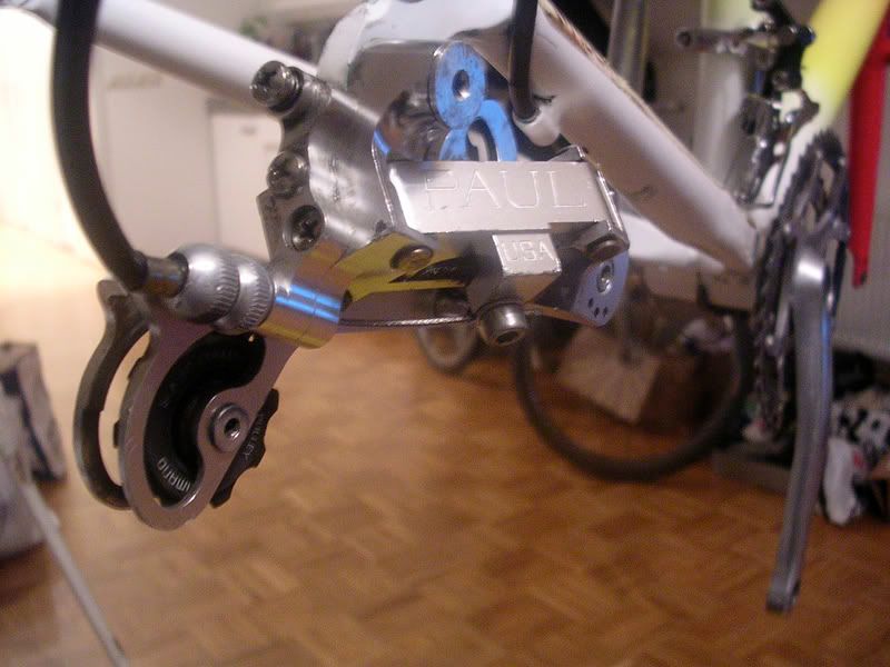

Rear mech.; Paul Comp
Front mech.; Shimano XT
Canti's; Onza HO
Hangers; Onza Chill Pills
Peddles; Onza HO
Saddle; Flite ti
Seat clamp; Ringle (silver)
Sharkfin; Shimano XT
Seatpost; "i" Graphite series (do not know the brand,..any of you?)
Stem/bar; Klein MC2
Quickreleases; Ringle (red)
next step made today,..put the brakes handles on and made the canti's work.
Next step is the shifters but I think I will buy a new cables set because they are pretty heavy while braking,...

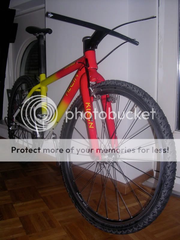

Sweet looking frame. Personally I wouldn't overdo the bling, XTR or even XT running gear with some nice brakes would do the trick.
stevet1":1o35fnt1 said:
Ah Family guy 8)
:mrgreen:
sooooooo funny!
thank you,..
I know what you mean.
My Pinnacle is all XT and that look realy nice but I have these parts available so it will do for now.
If I would be able to buy a nice NOS retro XT set I will certainly do that,...
