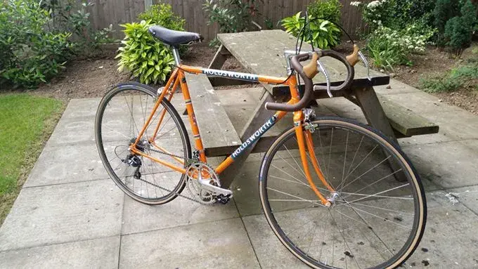

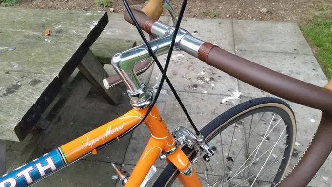

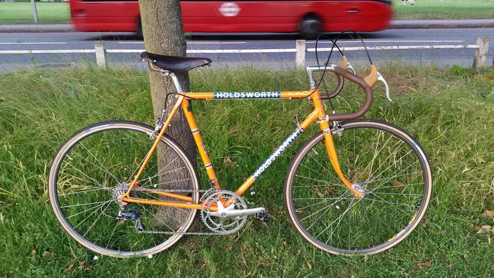

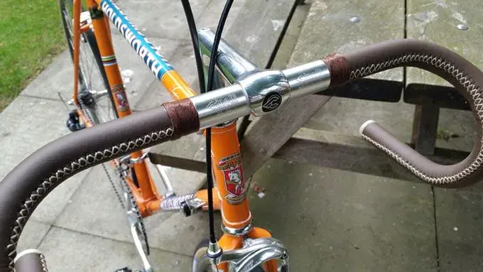

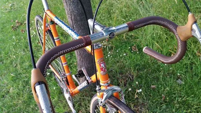

Bit of a mongrel collection of components, stuff I had left and some choices to make about what worked and what didn't work. Wanted 700c wheels, but it's a 27" fork clearance, so the deep drop brake callipers are a compromise although they are brilliant stoppers. Since it was never going to be a period correct build I didn't mind the Shimano Claris derailleurs either since I couldn't get the Campag stuff to work with 8 speed SIS shifters. All in all though, it really flies and braking and shifting is smooth as butter.

That looks nice - and I like the practicality of having some more modern stuff on it.
I have a part built one hanging on the wall in my garage which will eventually get done. Annoyingly, I can't seem to find a seat bolt which will close up tight enough to secure the post. Bought the shortest one SJS had and it isn't enough. Are you using a 26.8 post?
Now that looks really nice :). Maybe move the rear wheel a bit further forward in the dropout, but that's a bit picky : D
