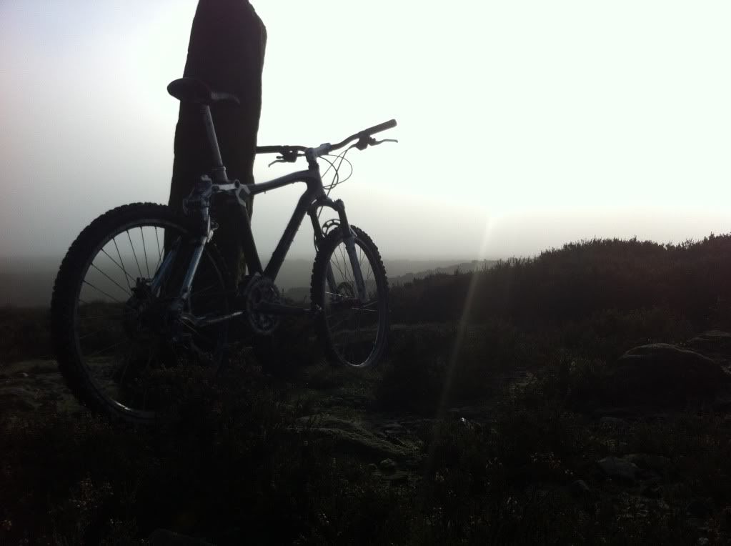

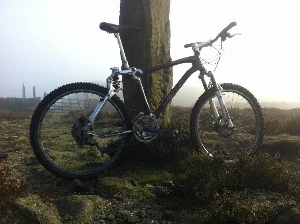

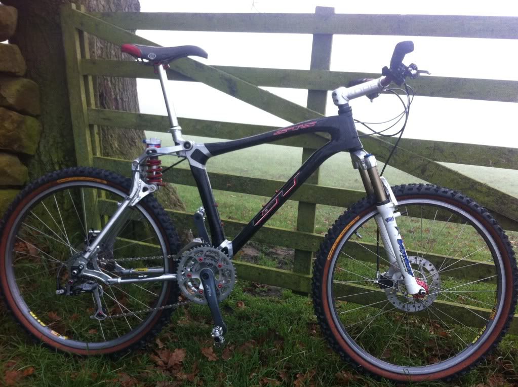

What kind of fork travel and axle to crown measurement do you have with that Bomber on there? Looks to me like the front end is up quite a bit from what the frame was engineered to handle. This can put a lot of stress on the down tube where it meets the head tube. It doesn't look so bad in the one picture but then when you consider the front wheel is shown 6" lower than the rear it's pretty substantial.
Tim it's looking great. Someday I hope to find a minty first year STS-1 in a good condition. What kind of fork travel and axle to crown measurement do you have with that Bomber on there? Looks to me like the front end is up quite a bit from what the frame was engineered to handle. This can put a lot of stress on the down tube especially where the alloy meets the carbon.
Thanks for your comments
The travel on the forks are 3.9 inches, I have the black painted front version which I believe has a stronger head tube, but looking at the picture it's just the angle of the shot.
