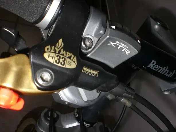

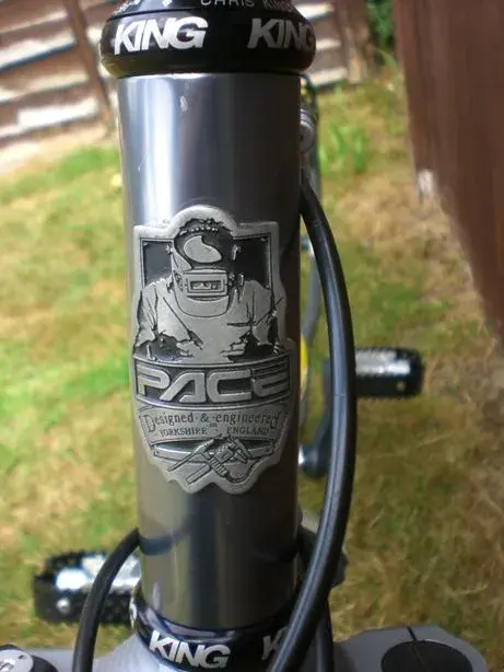

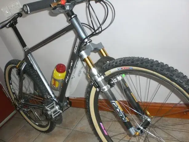

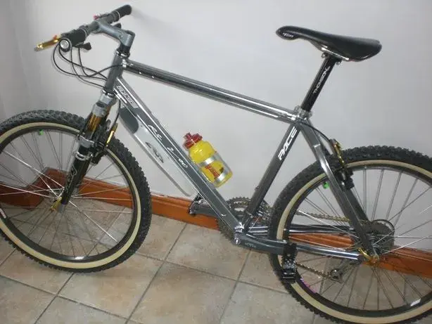

Interested to know what you guys think of her
Some before and after shots below.
Chuffed to bits with how its turned out, and if i can build a bike then anyone can ! (even laced the wheels myself !)
Only trouble is i am already thinking about my next project now !
Many thanks to all who have helped me out off the site with parts etc, ishaw, justbackdated, Caramba Kid, gil_m, geoff moorhouse, cornholio's RC200, xenophile, dead rats, yo-eddy and muddy funster to name a few !
Full spec as follows: Cost around £1400 which was alot more than i was expecting but i think she's worth it ! More photos to follow
Frame: Pace RC200 F6 Competition Chassis 1997 (7000 Series Aluminium).
Fork: Pace RC36 Evo Pro Class Limited Edition (1999)
Headset: Chris King Nothreadset (Black 1 1/8 )
Stem: Pace RC45
Handlebar: Pace Renthal RC130
Grips: Crank Brothers Cobalt Grips
Barends: N/A
Brakes: Magura Raceline HS33 Olympia Limited Edition Hydraulic Rim Brakes
Brake Pads: Magura Raceline HS33 Rim Brake Pads
Brake Cables/Hose: : Magura Raceline HS33 Hose
Cantilever cable hangers: N/A
Brake Levers: Magura Raceline HS33 Olympia Limited Edition Gold Levers
Shifters: Shimano XTR M952 Shifters 3x9
Front Derailleur: Shimano XTR M950 31.8mm Clamp, Bottom Pull
Rear Derailleur: Shimano XTR M951 8 speed
Derailleur Cables: Clarks Gold
Cassette: Shimano XTR M970 Ti 9 Speed 11-32
Chain: KMC X9 Light Chain Ti & Gold 9 Speed
Cranks: Shimano XTR M951 (110 BCD)
Crank Bolts: Brand-X Self Extracting Splined M15
Chainrings: Middleburn Hardcoat 24,36,46
Chainring bolts: RaceFace Inner, Onza Outer
Bottom Bracket: Shimano XTR M952
Pedals: Odyssey Triple Trap
Hub Skewers: Hope
Rims: Campagnolo Thorr
Hubs: Pace RC50 Front, Shimano XTR M950 Rear
Nipples: Brass 12mm
Spokes: DT Swiss
Tyres: Ritchey Mega Bite Z-Max 2.1
Tubes: Airwave
Rim Tape: Schwalbe 20mm
Saddle: Selle Flite Ti
Seatpost: Thomson Elite Inline 29.4mm 410mm
Seatpost Binder: Pace
Bottle Cage : Ringle H2O
Weight: ??
