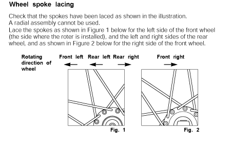

Yesterday I picked up two new rims, Mavic X317, 32 hole rims and an XT M756 front disc hub. Using Halfords 3 for 2 offer I got them for £44.70 using click & collect. Today I measured the hub and rims so I could order my spokes and placed an order with Rose Bikes for DT Swiss Champion spokes/nipples/rim tape a Shimano FH-T780 rear hub (none disc in black) and a new spoke key costing £42.26 as they sent me a £10 off voucher for registering.
So I reckon I have everything I need to build my wheel set at a total cost of £86.96, sounds budget to me for the spec. I guess this thread will run on for some time as I now have to learn how to build bike wheels :roll: .
