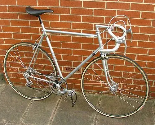

Well, 5 months on I've managed to re-equip the 'Ultimate' with some different components and get it more into the condition I wanted.
The aero brakes have come off (to go on something else eventually) and replaced with Weinmann 500 stirrups, Weinmann drilled levers and exposed cables. Suntour ratchet handlebar end gear lever, Cinelli 'Criterium 65' bars with 14cm stem and Benotto tape, Campag large flange hubs on Mavic GP4 rims 28 spoke, PMP cranks with 52 ring, SR Track pedals and Christophe clips and straps and Huret Jubilee mechanism. The tubulars are currently some Vittoria Rallys but I have some Vittoria Crono 7oz Silks waiting for serious riding!
I think it now looks very 1980-ish.
This is how it will look on Sunday at the Classic Bike Display

not ashamed of asking :?
but what is the rationale for these L shapes PMP cranks ?
what is the equivalent longitudinal classical length ?
is it supposed ti improve the lever effect :?: :?: :?:
or was it just a "marketing gimmick"

Answers -
Marketing and Sales - something different often sells.
Equivalent length is a straight line from the axle to the pedal, in this case 170mm.
Yes, it was 'supposed' to! But there is no actual extra benefit from the
'L' in practice.
See answer 1 above!
