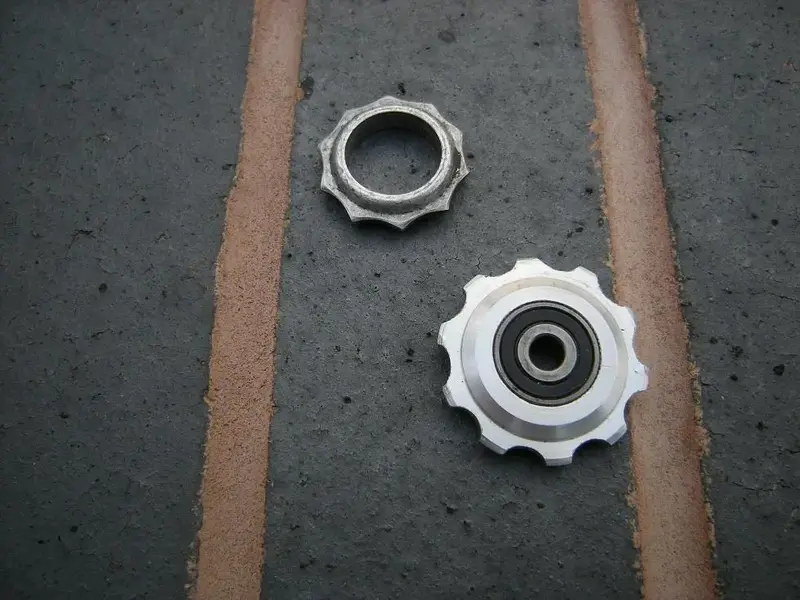

I work in a toolroom servicing press tools and often find my attention drifting towards messing with bike bits. It can be anything from just cleaning parts in the degreaser, stripping and rebuilding hubs/mechs and even making the odd part or tool as I need them.
This week I made a really good XT rear mech from two bad ones which left over a very worn aluminium jockey wheel with a pressed in bearing. The bearing was good so I started planning how I could knock up a replacement jockey using the miller and lathe (no CNC here). Aluminium is very scarce here, plenty of toolsteel though, but I did manage to source a heatsink from a pc which was perfect.
So much hacking and fettling later here is the result. Its not perfect but to be honest I'm chuffed to bits with my first attempt.
Thanks guys, I really hope it works ok. I'll put it on a mech and bike that I know shifts/works fine for a test run. Worst case scenario, I've got a new keyring :D .
