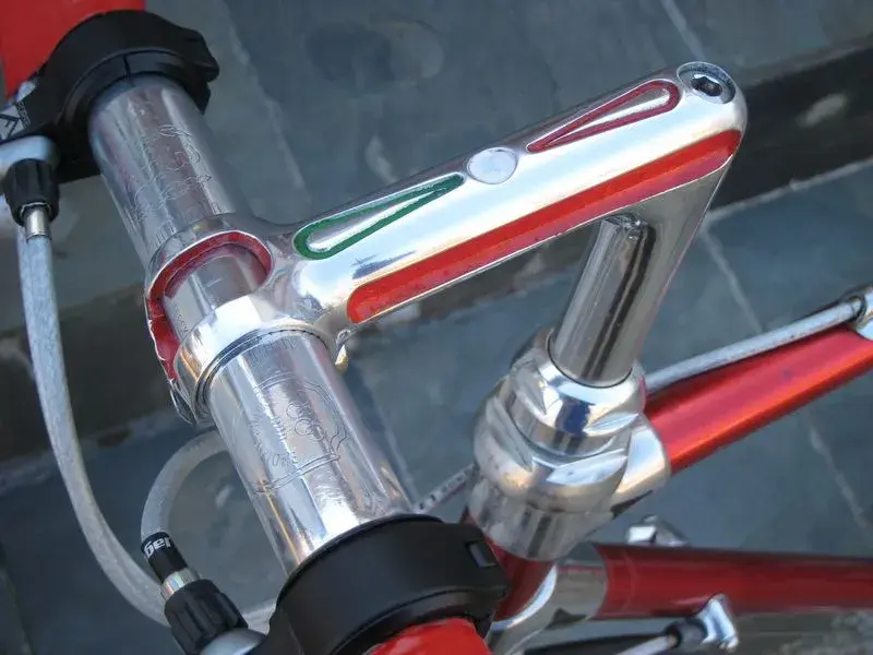

The swap meet had almost everything I needed for the bike build so even before the frame arrived, I was pretty much set up. The bars are a TTT Eddie Merckx model and the stem has a nice pantograph. I filed out various nicks and marks on the lugs and polished everything up. It didn't come with the cable guides for the top tube so I made my own.

I do like the stem though - and Delta brakes!

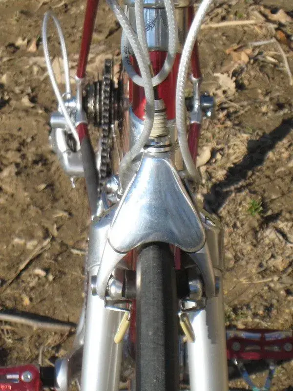

Yeah, I know not doing a period rebuild may be a bit controversial to some. But I wanted a fairly modern bike to ride and looked at this more as an "art project" than anything else. Silver, red, and black were the theme obviously.
A couple of answers. The shifters are 8 speed with a 7 speed Shimano freewheel. I also have a set of wheels that use an 8 speed Shimano cassette. (Yes the wider 130mm wheels fit easily without stretching which is something I only tried after installing the 126mm wheel and seeing how much flex there was between the dropouts.) The shifting works fine and the 8 speed cassette has a 32 tooth low gear and the Chorus derailleur handles it.
I originally did not have the in-line cyclocross levers but the Delta brakes have such strong spring resistance that I found my hands getting tired and cramping on the regular levers under extended braking just riding down a long hill near my home. So it was more a safety issue. Even with Cool Stop pads, that I eventually installed, braking takes more effort than on my other bikes and I knew this could be an issue when I bought the Deltas.
