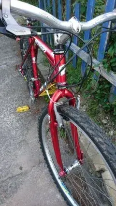

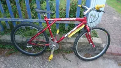

Anymore pictures? :)
And i prefer it with black tyres, and maybe a black stem too :)
mark
Yep, agree on the tyres, got the wtb velociraptors on as nature intended.
Once I get the cable on its finishing touches and photo time :-)

And the finishing touches:
crud catcher. The old one was purple, I don't have purple but I do have a fetching yellow one. Nice. On.
DCD. Can't decide whether or not to do this, but I had one then so MIGHT fit that too, think I have one in the box.
Chainstay protection. I THINK I still have the old lizard skins type thing with a DCD cutout. If memory serves its the freebie off MBUK. See above, might go that way. But when I ditched the DCD I used a strip of offcut inner tube and a few cable ties to stop the knocking and clanging. Might go that route instead.
