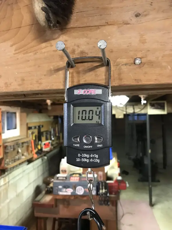

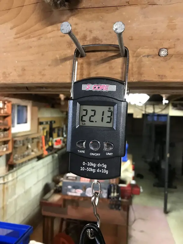

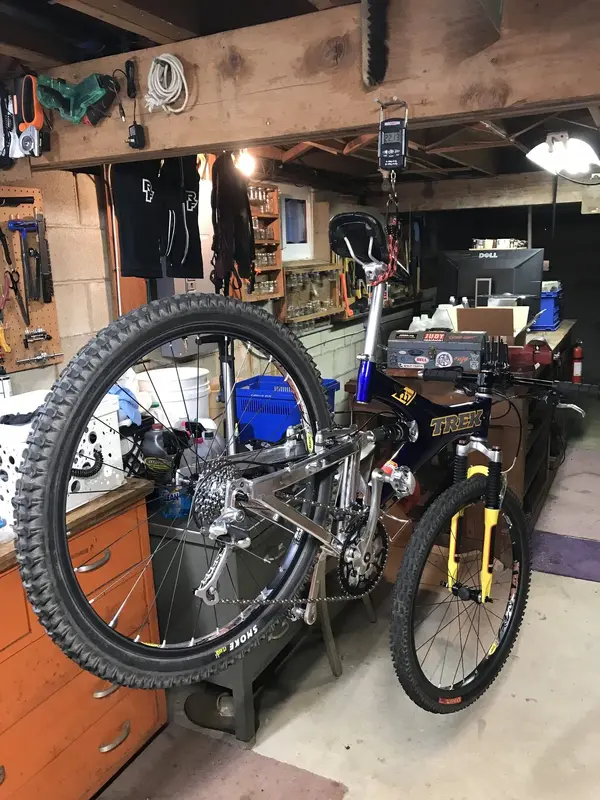

Well, it didn't hit 23, as expected.
Just a bit over 22! :cool:
To be fair I still need to add some small plastic bits, my chainstay protector, a few other things, but ... damn. This is even better than I'd hoped!
