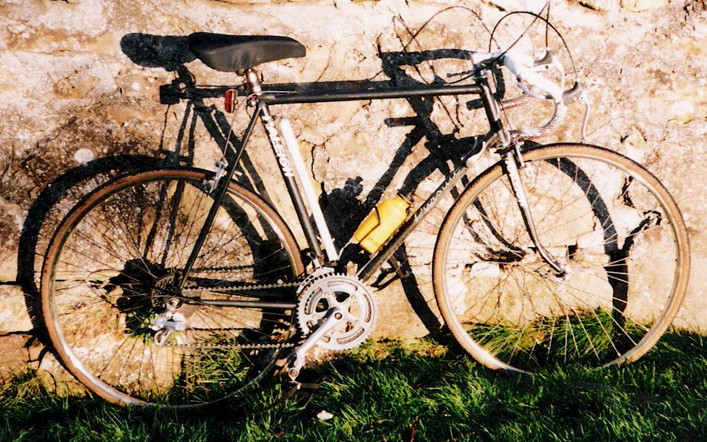

ian.allen2":dt6sjyac said:
I had one of those, years ago (it was old and unfashionable even then!)
Looks like yours has been rid of the lethal steel rims though? The bike was really just a touch too big for me but it was the first semi-proper road bike I ever had and I was fond of it.
I have seen a few lately. Must be coming popular now. lol. Yours looks good. When did you own yours. Was it new when you got it.
Nah, it was second or third hand even then! It was my main bike around 93/94 - sadly I don't have it at all any more, brother went off to the scrappy with it a year or two ago along with a pile of other stuff "tidied" from the sheds at my parents' house :(
Having said that, my wife got me a "modern" replacement for my birthday not long after - Genesis Aether 10, very similar styling in black and white but an awful lot lighter and faster! I still miss the friction-only downtube shifters though, it's not a proper road bike without those as far as I'm concerned...
