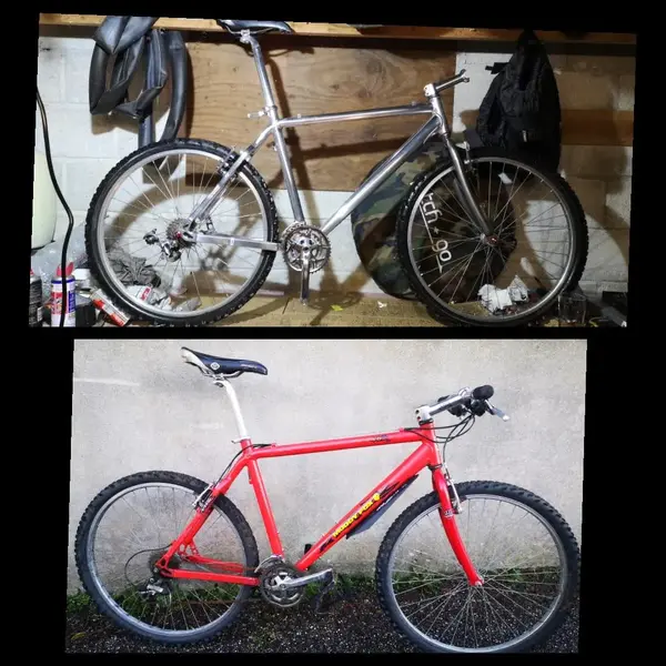

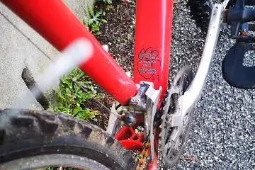

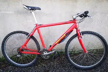

Having been browsing various sales platforms I stumbled across a muddyfox with some nice geometry at pocket money price.....however it was in red, never been fond of red nor red rust everywhere ....plus I wanted to give a fingers up to the brand snobbery of so many people who don’t realise how important the bikes and the marketing tool of muddyfox was in the instrumental days of the British mountain bike origins and where we are today. As a brand, they were cutting edge but unfortunately got dissolved into that dreaded falcon brand in the late 90s along with claud butler, British eagle and a few others so here it is ....the beginning

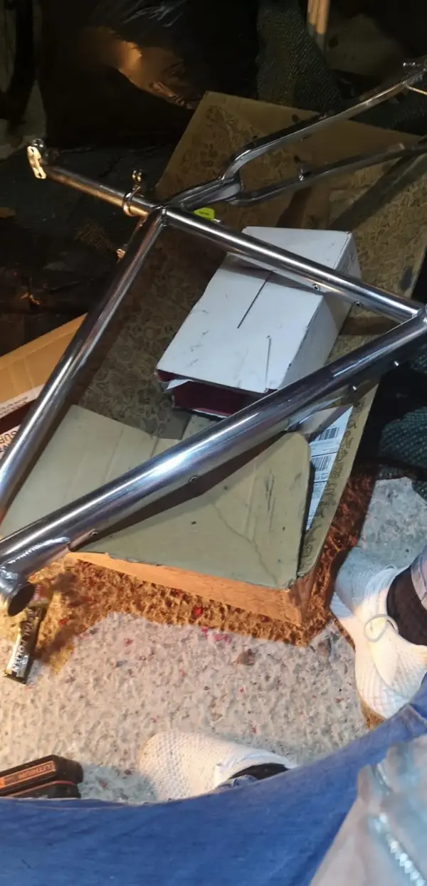

Firstly time to realise I didn’t have any of the tools I needed ...... amazon prime here I come ....bike stripped and now to decide on the colour. Always wanted to do a gator fade as per Klein but didn’t think this was the one to practice it with. So ....let’s strip no polish it ...should be easy
What a ball ache, paint stripper alert

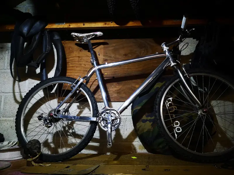

I’m now thinking I should have painted it instead, grit 400, 600, 800 and 1200 followed by t cut. After a bit of advice on Facebook page, a mop was purchased for my drill, autosol and moms polish followed by 18 hours on and off in the garage .....which incidentally quickly received a heater and a fridge...oh and the camping chairs out the t5

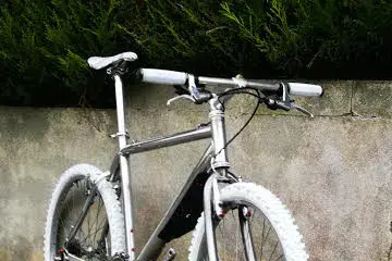

I polished the frame up with some heavy diamond bright wax to seal .........if good enough for range rover , good enough for the muddymofo.........followed by first mock up using existing wheels n tyres ....

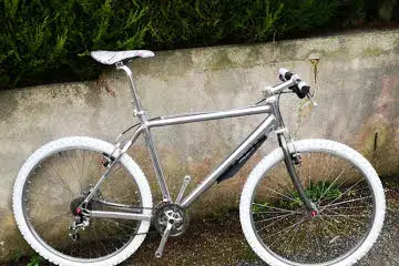

So I polished the cro mo forks, the existing seat post, the original cut down bars and stem. Put some stx v brakes on, exage front and rear mechs along with existing stem that all received a polish.
At this point really hated the tyres, set no grips .....being a bit of peacock and working in design [ tattoo studio ] I looked at options ....white ONZA tyres nos......how f##king much ...seriously????? Kenda tyres followed, a amazon special seat that would look as near to zebra pattern as a blind man would think ...non-white grips ....oh red shiny bits ...so brake bolts, retro quick release’s. in red ....hang on don’t even like red ...but looks good in small doses ...followed by first mock up

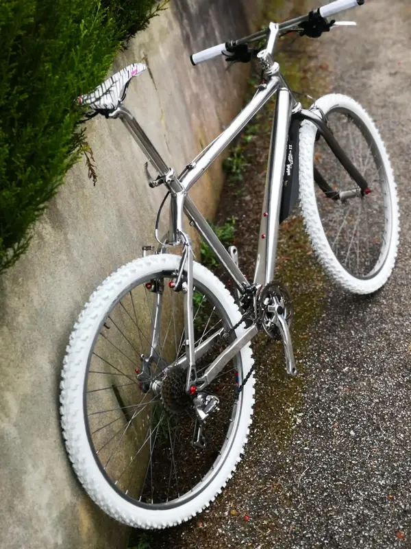

To say I’m happy with it so far is an understatement ...then I rode it...........feck me used to riding a modern 29er and this thing felt so slim and so unstable in a addictive sense ......had some good feedback from friends so sod it ....xt mech, 8 speed xt cartridge, Mavic rims front n rear ....lighter crank ....haven’t a clue what model but came off a 96 cinder cone ...and yes got polished ....more red anodised bits appeared through the letter box ....waiting For red jag wire ......and now I really want some Girvin forks ........tbc
