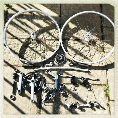

Hi, I recently acquired a 1987 Muddy Fox Courier and I am trying to find the original component specification for this vintage MTB.
Unfortunately I had to bin the frame, which had a completely seized seat post pushed all the way in, but the parts and wheels are complete and I want to sell them as a complete and original group set but first would like to make sure what I have stripped off the frame, cleaned and serviced, was what the bike was originally built with.

Looking a the small pic you have provided, and i cant see it very well, but im guessing the chainset and sprockets have been replaced in the bikes life, as they look too new for original spec.

Chainset is definitely not from the bike, the one you have there is either 300lx or 200gs which were 1990 onwards. I think the rear wheel has been replaced as the hub should be a large flange sansin like the front.

Many thanks for sharing your thoughts Sinnerman, Augustus and drcarlos :-)
It seems that apart from the rear hub and crankset, the rest is original component spec (as fitted to the 1987 Muddy Fox)
