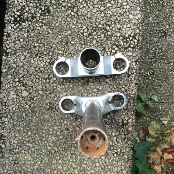

Hi There,
has anyone tried replacing a Manitou Three crown with a SX 97 crown - they look fairly similar on pictures.
Thanks a lot!
The 97 sx didnt have a removable crown. Manitou 2-4 crowns can be found here without too much difficulty if you need a new one
What about the Mach 5 and Pro C versions??
Quite sure they had a removable crown. Not sure there are any leftover given the rate I snapped them at. It's a wonder Manitou didn't get sued beyond recovery. Bloody awful so proceed at own risk.
Jeffro
Mach 5 are... i think... but after than, no they were press fit... but why? Surely it's just as east to get m3/4/efc crowns...
Will not work. The spacing between the stanchions has changed in the transition from Manitou 4 to Manitou Mach 5. The older Manitou forks (M1-M4) had a wider spacing than the newer Mach 5 and onward. I tried but they're not compatible. It seems to be quite difficult to source a Manitou 3 or 4 crown and alloy steerer in 1 1/4 with a decent length. Plenty of threaded steel steerer ones about though.
Exactly right - the crown is actually removable, the stanchions have the same diameter, BUT the spacing between them is much wider on the old Manitou 3...see picture attached.
