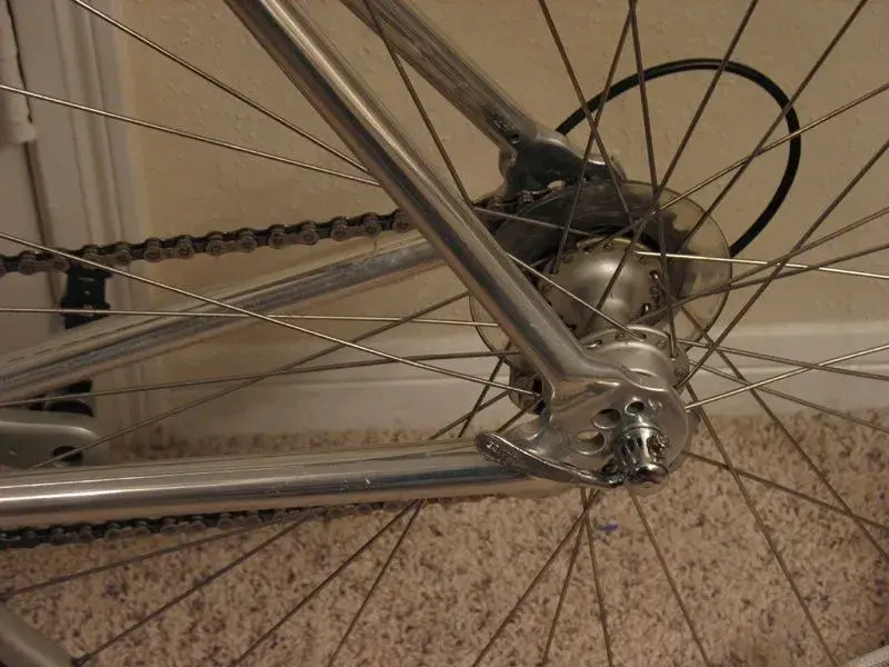

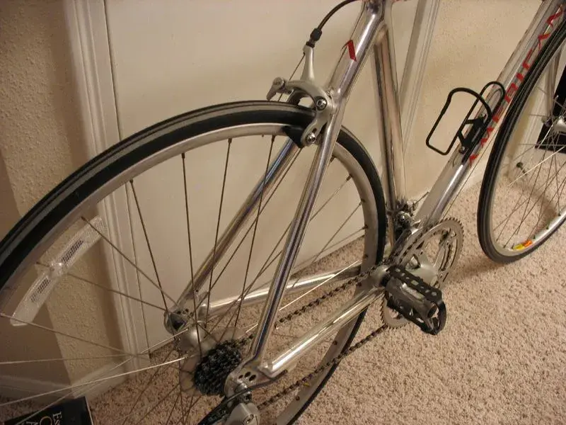

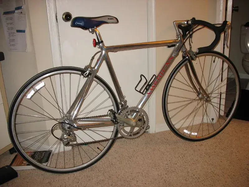

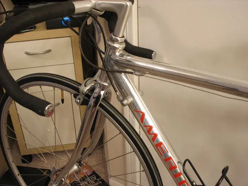

American did make smooth welds for their road bikes. The road bikes are a rare bird indeed. I am only aware of three of them that I've seen posted. I don't know how many were produced but it wasn't many at all.
The smooth welds were for the road bikes only as far as I know. Note the picture of the smooth welds does have a shifter attachment on the downtube. I checked with someone who knows the Schilplin family (who owned the company) and to the best of his knowledge also, only road bikes were smooth welds. There might be an oddball smooth MTB out there somewhere, who knows?
A guy wanted to sell me a road bike a few years back and I regret not picking it up, so it goes. I've attached a few decent quality pics of it.

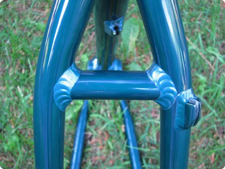

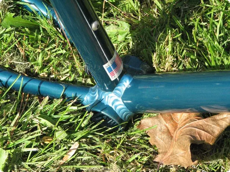

I've also attached a picture of an NOS M16 some dude has.

'He wo hesitates is lost' (that's what my Grampa always said) guess it applies here - I feel you pain, that bike in the pic is stunning.

Having that must make up for it a bit though? :D

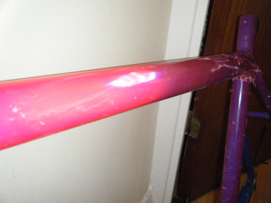

Rubbed it back to primer,
when I rubbed down four (brush applied) colour coats which looked fine prior to being flatted back, the pigment was uneven
I'd be fine for a spot touch up here or there, but it's a fairly large prominent area I'm trying to deal with, so it's got to look well matched and even in hue
This enamel is bloody tricky stuff it's kind of translucent so the colour slowly builds up with each successive coat, so with brush application getting those coats of even thickness might not be possible!
Even if I sprayed it I'd need to consider how to blend/feather it in to the sound paint around the patch - I'll persevere a bit longer
I'm going to say this once, and only once, lest anyone think I'm going all gooey and saccharine but I like that you are doing your best to restore the frame.
However...MUST....NOT....SAY....ok, got over that, never mind.
Have you tried one of those modelling spray guns?
They are designed for applying very thin even costs of enamel.
