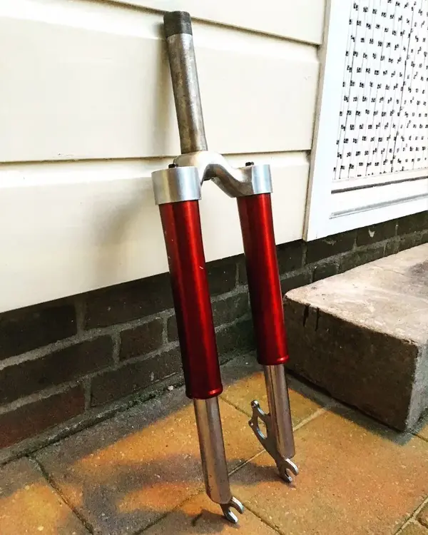

Took the bike apart today.
Started stripping the fork and was totally surprised that the red anno color came back, without hardly any damages for the part that i have done so far.
I think I am quit lucky with this example
All parts : Front Mech, Rear Mech, Cranks, BB,.. all M900 and in a perfect condition. No signs of heavy use anywhere.
Even the Elastomers look like the have been installed yesterday ,.. still soft and like new.
So within a few days I will start stripping the paint. For now the paintstripper seems to work just fine on the fork.

Nice San Andreas with 2th generation Suspenders !
the project is a bit slow at the moment but i put the Suspenders back together.
Hope to get started with the polishing this weekend
