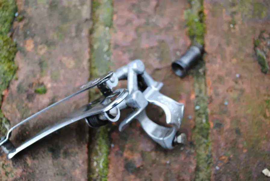

I have some early Campagnolo bits you are welcome to, I'm sure I have a black mech hanger and an early GS front mech.
hey - yes please!
guessing it's a little later than the afore mentioned "matchbox" type but it's certainly more inkeeping with the style (and probably works better) so if the offer's there..
