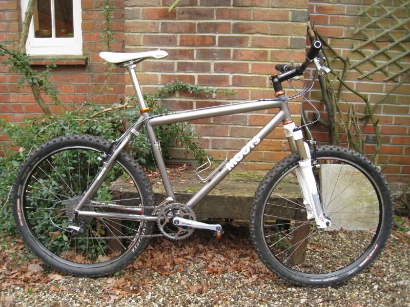

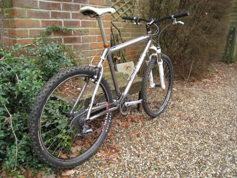

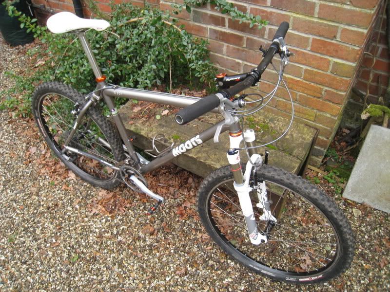

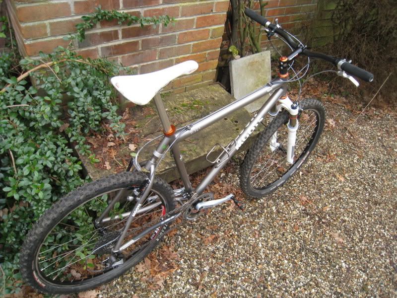

Up-date 4th Feb '11
Put it on a bit of a diet today ;) it's about 20-21lb now, far more respectable :lol:
Spec:
Frame: 18" Moots YBB (2000 yr) - 1893g
Fork: SID Race - 1521g
Headset: King No-threadset - 109g
Stem: Syntace F99 - 100g with ti bolts
Handlebar: X-Lite Carbon Riser - 174g
Grips: Extralite - 32g
Brakes: Pauls Motolite - 372g
Brake Pads: inc.
Brake Cables: xtr - 100g
Brake Levers: Pauls - 124g
Shifters: Pauls/Dura-ace thumbies - 133g
Front Derailleur: M952 - 112g
Rear Derailleur: M950 - 205g
Derailleur Cables: xtr - 75g
Cassette: M970 - 251g
Chain: KNC 9SL - 246g
Cranks: Middleburn Duo - 524 with alloy bolts
Crank Bolts: FSA isis - 39g
Chainrings: Middleburn 42,29 - inc.
Chainring bolts: alloy - inc
Bottom Bracket: American Classic isis - 153g
Pedals: Crank Bros 2Ti - 220g
Hub Skewers: KCNC - 45g
Rims: Stans
Hubs: Tune
Nipples: Alloy
Spokes: DB Stainless blade - 1302g wheels total
Tyres: Bontrager Mud X 2.0 - tubeless - 530g x 2
Tubes: NA
Saddle: Flite Ti - 204g
Seatpost: Thomson Elite - 288g
Seatpost Binder: Thomson - 27g
Bottle cage: King Ti - 29g
Weight: 9343g / 20.6 lb
Cheers
suburbanreuben":m6gx5qin said:
Is that the actual measured weight, or adding up the grams? :wink:
I don't have the facility to weigh the whole bike accurately, so I weigh each component before assembly. I'm sure it's reasonably accurate ;) I do have a spring balance that will take the whole bike, and that shows about 21.5lb, so seems about right ;)

Bar the color of the flite, that looks even more fantastic :shock:
And that weight, that´s close to nothing :D
Great job on that one!
Jan
bonty98":16p1cahw said:
Hey Man!
Jan
Thanks Jan :)
I think the white Flite goes well with the forks and decals :? - what would you suggest? - black? brown?
