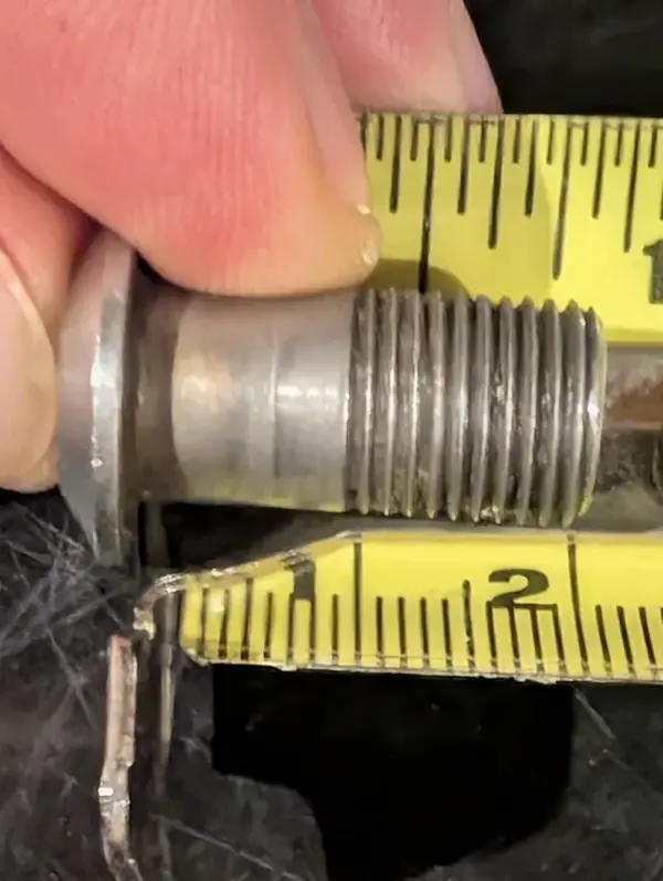

Thanks. I don't have a pitch guage but tried to get a pic that could help confirm dimensions needed.
I recon it means it's 1..0 pitch as there's 10 threads in a 1cm length of the overall shaft.

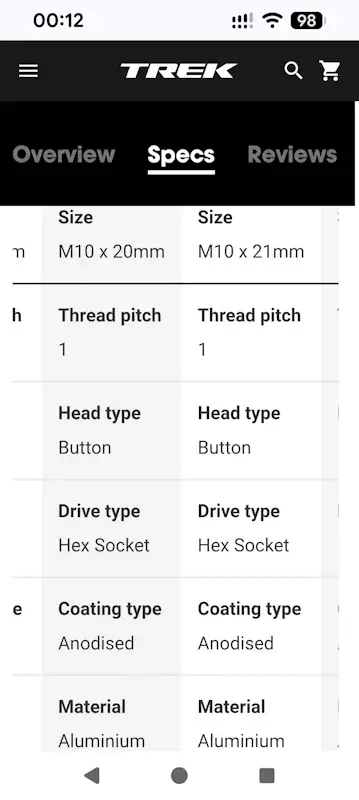

Looking at the trek bolt spec, they could be a match, the only thing I'm not sure about is the length. 20 or 21mm? Assume measurements are not including the button head?

I misread the exploded diagram, the bolt is m10x20 so I think I've answered my own question.
I think my only outstanding question is how can I tell how much thread Vs plain shaft there is on the trek bolts?
