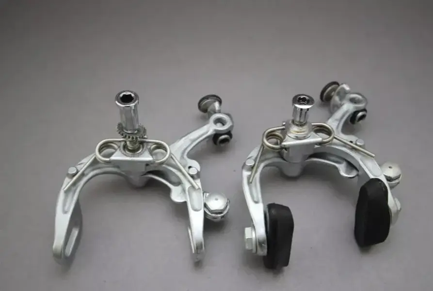

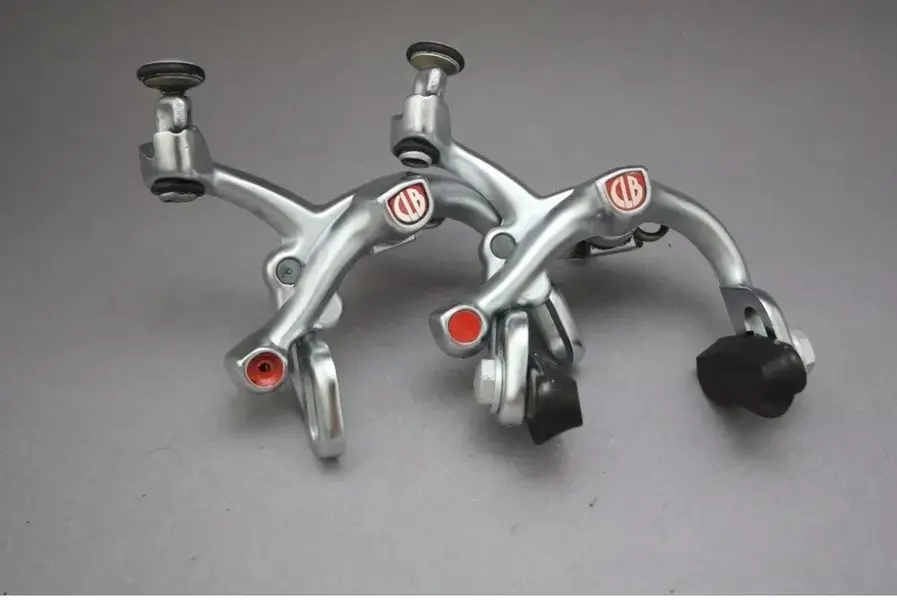

Quite possibly the worst (and the lightest) brakes I've ever used, Clb professionnel. Every nut and bolt is aluminium, which is nice, gets the weight down to 160gr the pair. However... Those brake blocks are tiny! About 40% less contact than regular on the rim, and in the rain as much use as a chocolate fireguard.
And did they squeal? They're french, of course they did!
I had some CLB brake calipers. Not the pro level ones, they were a bit more mediocre. The arm snapped midway down as I was descending down the garden path. Fortunately I was only doing about 5mph but dred to think what could have been.
Took em back to swap for some weinmann 500s/730s
I had a set of early CLB Professionals, back in the days before alan bolt fittings and before they went overboard with alloy bolts. They were still light but had bigger brake blocks and were solid in use. Years later I was disappointed to discover how poor later versions were.

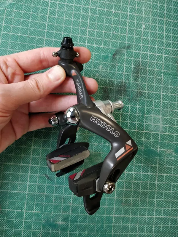

I have these X-Eras which have a similar quality feel to the Mavic calipers, albeit with a different finish. I also have a pair of QT-EXE which are again the same casting, with cheaper seeming pads, a different cable attachment and round stock spring rather than the flat spring used in these.
Modolo was prolific at rebranding these brakes, all the ones I've spotted in this family style are as follows (although there may be more)! Velobase has photos of most of them; link
