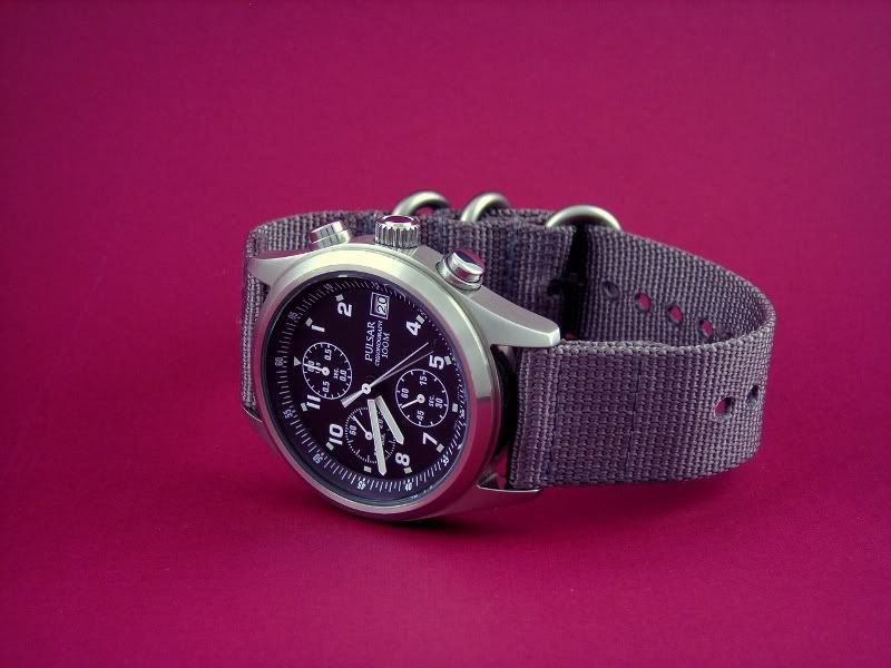

Seiko are also know for their chronographs - watches with built-in stop watches - and this is something of a speciality for Pulsar too. This model was widely issued in the RAF and is easy to find online:

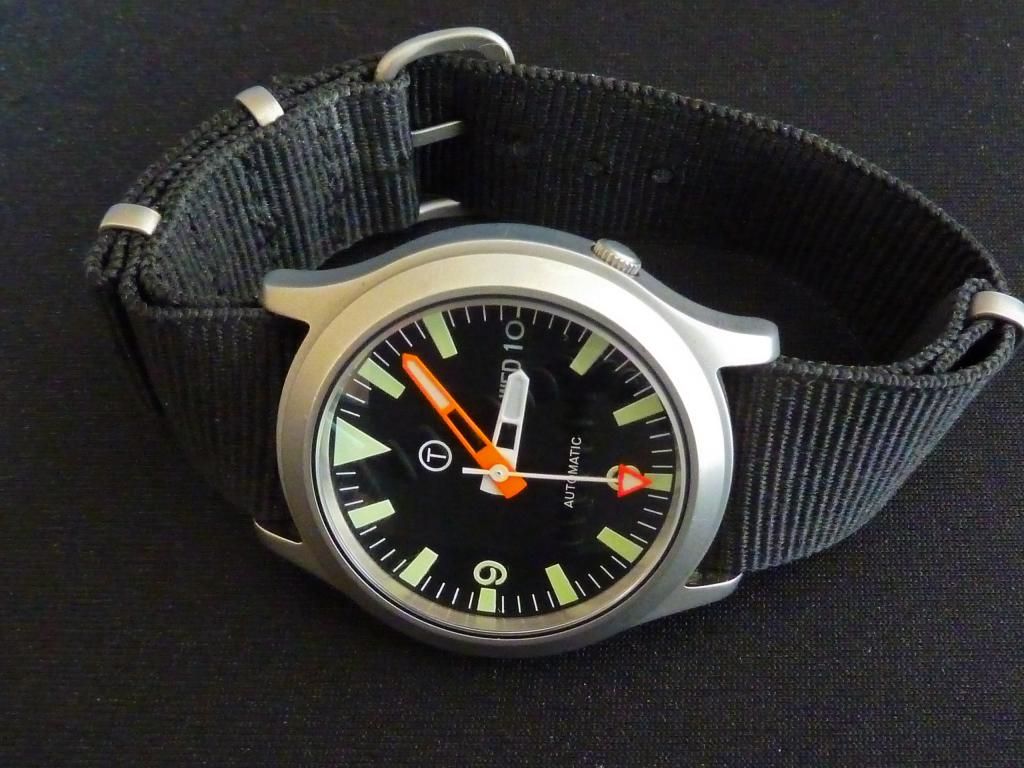

The SNKH63 is a cracking watch for very little money. I think I paid about £70 for mine s/h on ebay. It gets worn mostly when I'm on my mtb as a heavy watch shakes about a bit and quickly gets uncomfortable. Here's how it looks now with new hands and dial from 10watches.com and a domed and coated sapphire from Yobokies -
Good point! And great watch. Yobokies stocks stuf for modding the snk's - and can mod a watch you buy there too. I have a yobokies snk mod:
...And 10watches is the other main supplier of modding components.
