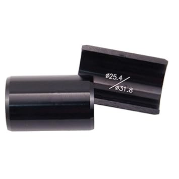

-31.8mm handlebar diameter, solves a problem nobody had, but now I can't freely mix and match my spare stems/handlebars
