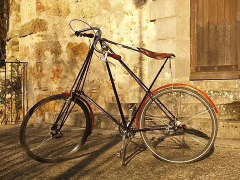

It reminds me of a crazy looking Danish bike I saw recently that instead of a toptube had a long leather "belt" that the saddle was directly attached to.
I can't remember what the hell it was called though but looked like a huge upright Moulton.

Hi Tazio.
Yes I am sure there are some Pedersen genes in there somewhere 8)

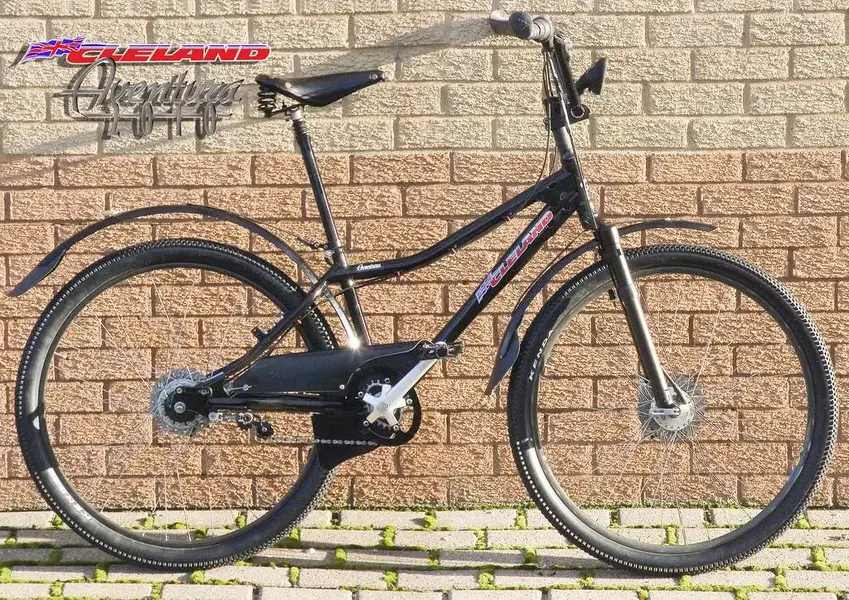

The bike that Geoff Apps and I are trying to make lighter is the Cleland TT shown below.
The TopTrail is not a Geoff Apps design but was designed by Adrian Griffiths and made by David Wrath-Sharman at Highpath Engineering.

Pedersen!!
I've been trying to remember that for over a month now. There's a rather eccentric character rides one around Edinburgh whilst wearing a striped blazer and a straw boater.
I had a good look at it last month and it's a fascinating device.
Tazio":2wc8n299 said:
Pedersen!!
They're now made in Denmark, but the originals were built in Dursley, Gloucestershire by Danish engineer Mikael Pedersen who'd moved to Britain towards the end of the 19th century.
If you're ever in Gloucester, look for the transport annex of the Gloucester Museum. They've got three Dursley Pedersens (lady, gent, and child) in the window.
http://www.livinggloucester.co.uk/histo ... en_cycles/
http://dursley.dk/galleri/thumbnails.php?album=7

Pedersen: not dissimilar the Cleland in riding posture.
