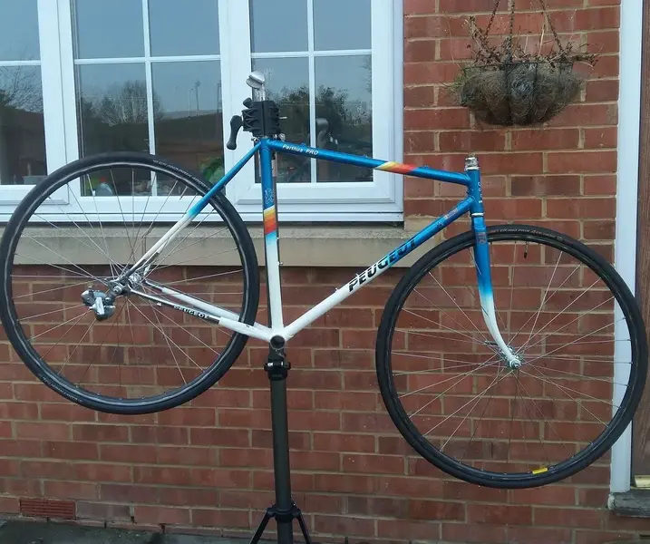

Misaligned Peugeot 753 frame - opinons

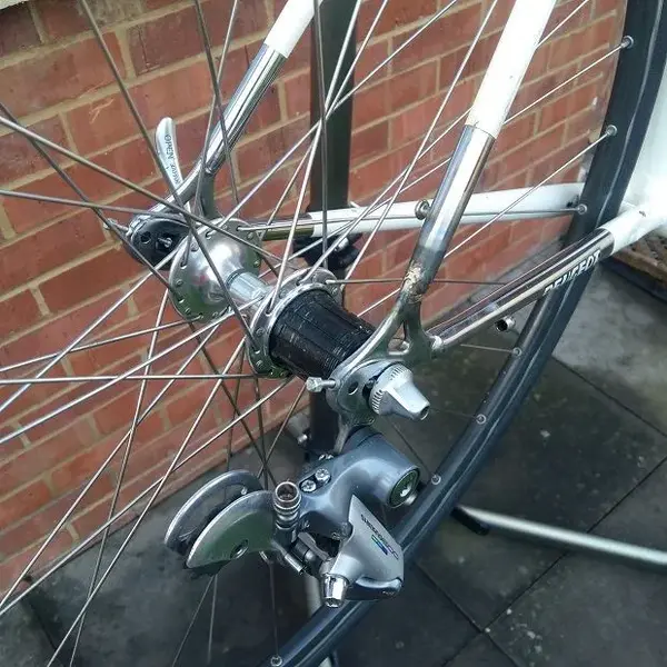

Its back! Basically the R/H rear dropout was heated to allow the frame to be pulled back into alignment, whilst the chrome has darkened in a small area...initial testing shows this will mostly polish out but the main objective, is the frame is now straight and ready for building up, I'll get a pic of the repair on here later. its cost me a fairly insignificant £35 and whilst it might've been easier to get hold of another frame....52cm high end Peugeots aren't exactly falling from trees these days. Besides, this was my dream frame back in the day - nostalgia picked the subject.

So what was the framebuilder's opionion on what caused the misalignment - left the factory that way or was somehow bent in an accident/storage situation?

It simply looks like careless storage damage..all tubes are intact and certainly nothing has been reheated until this repair...an odd one though :|
Anyhow, I've got a pretty mint 600 Ultegra groupset to go it, albeit with Dura Ace 7400 cranks, here it is fitted with the wheels - Open 4cd's on 600 ultegra hubs (funnily enough identical to the first set of proper wheels I ever had back in 1989!)
The 2nd pic shows the damage from the brazing, hopefully my polishing skills will help remedy this, though I'm not too concerned as this whole build by the time i've sold the surplus parts and donor bike bits will only have cost me £120...including the repair!

I'm glad it wasnt a factory defect. The repair doesnt look bad at all, I bet it will polish out, but it isnt even bad as is. That bike is from probably my favorite of Peugeot bikes, I think those years were their high point for racing frames.
