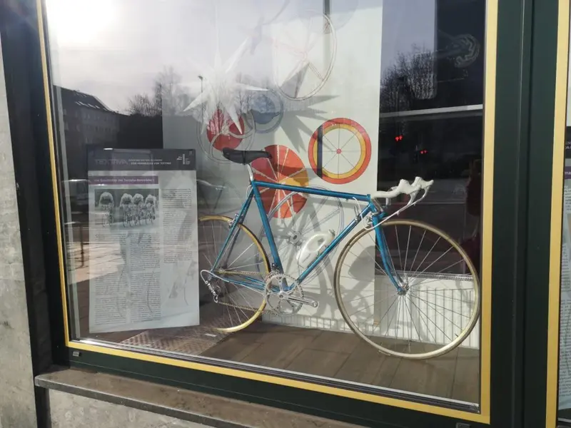

This East German Textima from 1979 was contemporary to Mike's creations, who knows whether they were designed independently or if he was aware of the strategies of the DDR builders. They certainly knew how to get very low, by doing away with a traditional stem and mounting the bars directly onto the fork crown. A lot of aerodynamic bang for not a lot of bucks.
There are about half a dozen varieties of this road going Textima, most of the examples are on Pedalroom, there are also a few in the private collection of TT bikes near Zaragoza Spain.
I was lucky enough to handle this very bike in the metal before it went back to the museum in Germany and it had a dozen or so features unique. Notably the hand made canti brakes mounted behind the forks, brake cable routed through the top tube/modified Campagnolo seat post and out via a tube to the rear brake with no outer cable. The routing of the gear cables was equally bizarre.
