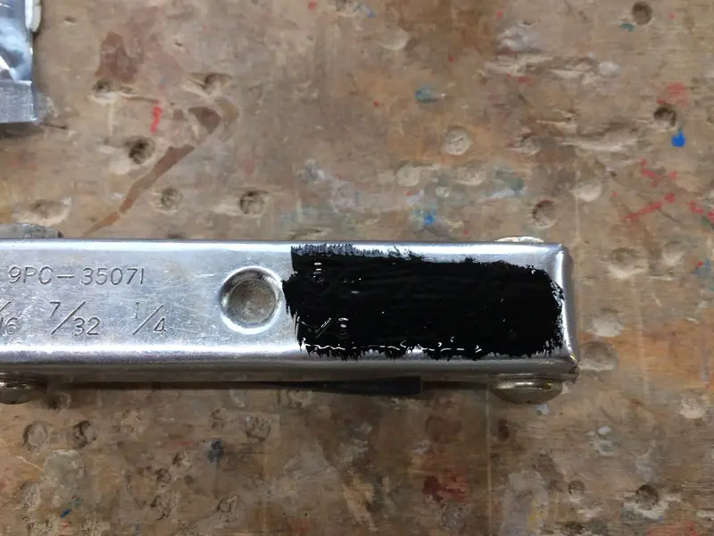

As the others have mentioned, just paint it, I wouldn’t be too concerned about neatness just get a rag with the appropriate paint thinners and wipe off excess/overspill.
Wait for paint to cure but it’ll be easier to wipe off before it has fully hardened. Test on inner face of crank first.
It can also help to wrap the thinners infused rag around a flat block of wood.

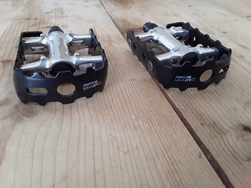

Do all my pedals with humbrol model paint. Same as above, paint over, wipe off with rag with a bit of alcohol on it....

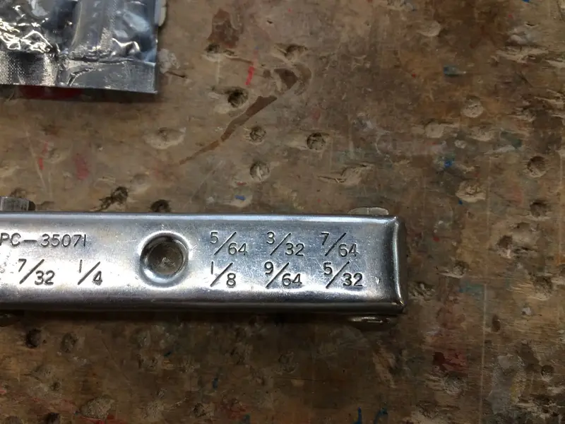

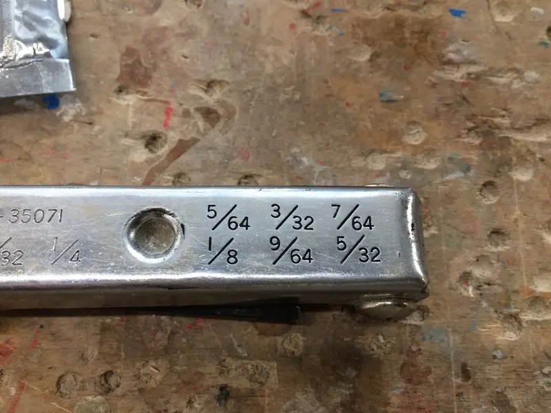

No a perfect example, but i had lost some of the lettering depth on the cage through sanding out damage!
