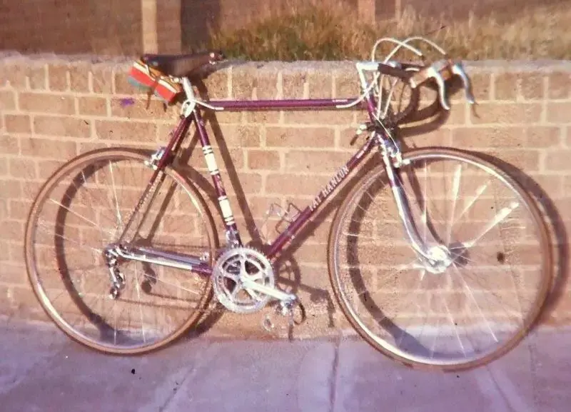

enclosed is my Pat Hanlon taken in 1964 featuring the self same Mafac Top 63's and Universal levers

Blimey.............is that really a colour photo from 1964 :)
Class act :)
That pic of a red Walvale looks a bit suspect to me in terms of braze ons and age...
Shaun
Class act :)
Shaun
It is a walvale though, judging from the 'W' that is engraved onto the fork crown
Maybe it would be better to complete it with MAFAC levers than buying hoods for Universals?
Can ordinary (from 'Racer') MAFAC brake shoe be threaded? Do you have any spare to compare if they are the same?
I am looking forward to see restoration and new photos.[/quote]
in my humble opinion I think you should keep the original levers as it was the done thing back in the 60's to have your Mafac centre pulls coupled to Universal levers as the full hoods on the Universals offered much better grip and cushioning, I can't recall anyone in our club not using this combination on their lightweights......if you do decide to change anything I would suggest that you offer the Top 63's on eBay (Worldwide) where they could possibly raise £200.00 or more and then purchase a pair of clean Mafac Racers (approx.£25.00) that would be perfectly in keeping with the era and the money you have left over would fund a large portion of your rebuild[/quote]
+1! Universal levers were used with all sorts of other stirrups, I used them with Weinmann 500's as on my avatar. The Top 63's were advertised by Mafac as being the next great advance in braking but I can't remember ever seeing them in use by any of the pro's who seemed to stick with the standard 'Racer' version. Not very easy to set up I think and as for replacement shoes........................ :roll:

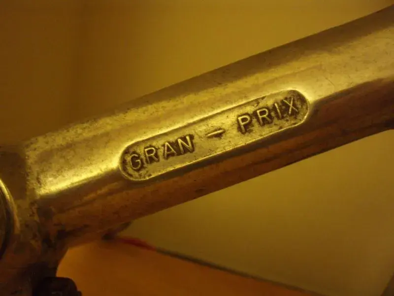

First image is of the Ambrosio Gran Prix stem, it has cleaned up quite well with some Autosol and elbow grease.

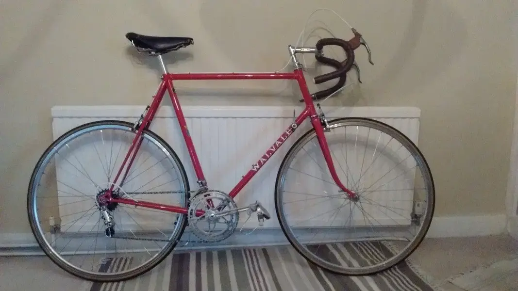

Have just come back to RB after a while away and after seeing another thread on Walvale cycles, thought I'd post a new photo of mine. I did post a thread showing the completed bike here viewtopic.php?f=23&t=258025 but there was not much interest in it. Since then I have changed a few things - adding a stronglight 49D chainset, lyotard pedals & gum walled tyres.
Of course it is pouring down outside so just had to take the photo inside which doesn't come out too well on my camera phone so may have to take some more when (if) the sun comes out :D
This bike will probably annoy the purists as whilst I kept as much of the 1960's period kit as possible, I have used some more modern parts on it, e.g. NR rear mech, 700c modern rims, 49D chainset is late 70s. At the end of the day, I think I have done a sympathetic rebuild which isn't far off how it would have been in 1963 and it hasn't broken the bank. And best of all the bike is actually rideable rather than just being a museum piece :D
I was quite pleased to see via my Strava stats on an 9 minute local climb, I was only 15 seconds quicker on my full carbon uber bike than on the Walvale, which is more than 50 years older.
