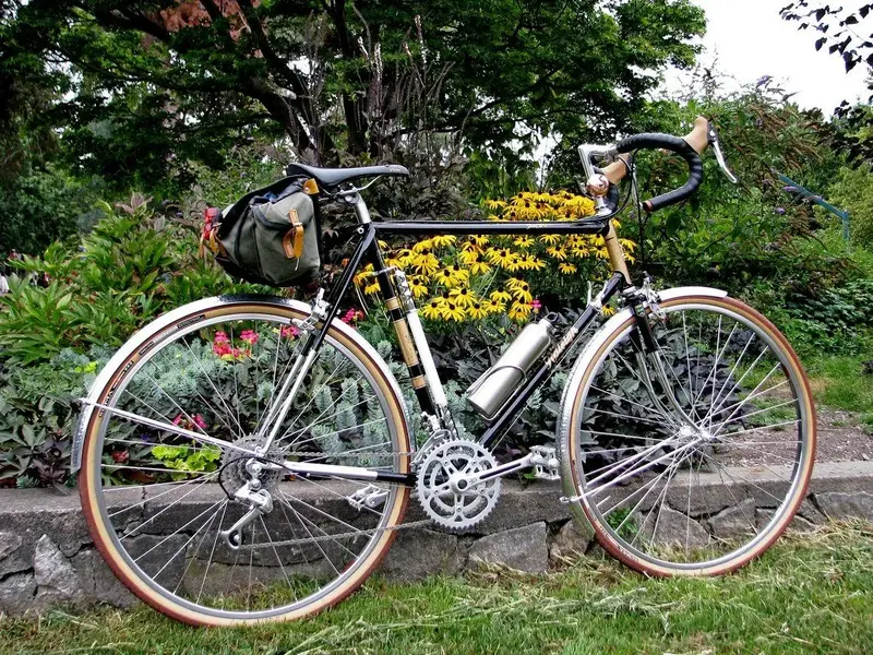

I am using Tektro R539 dual pivot side pulls with V.O. ( Velo Orange ) 45mm fenders and 35mm Soma 700C tires on a Raleigh ( '84 Gran Tour ) and they have a good amount of vertical adjustment for the pads. They also come with nutted mounting for older bikes, which is nice as the selection is not great for newer brakes for non recessed frames. I believe V.O. make a narrower fender as well, and have smooth as well as hammered versions and they come with everything you need to mount them ( pre drilled ) including the leather washers. Check out their site if you have not - lot's of goodies for sale!

Thanks for the help! I already have the tyres, so will have to use those for now. What is so different about the stronglight and ska mountings? They look the same in the pictures. My lbs can get both, but the stronglights look nicer.
Any opinions on the Miche 57mm brakes? They seem to get good reviews and are a lot less than the tektros.
And what a lovely Raleigh :)
