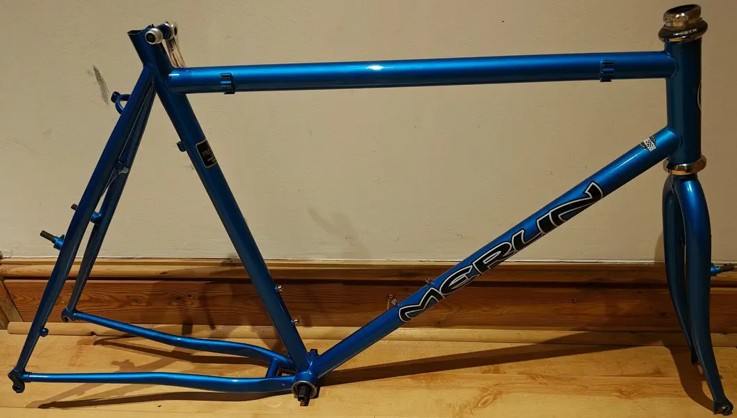

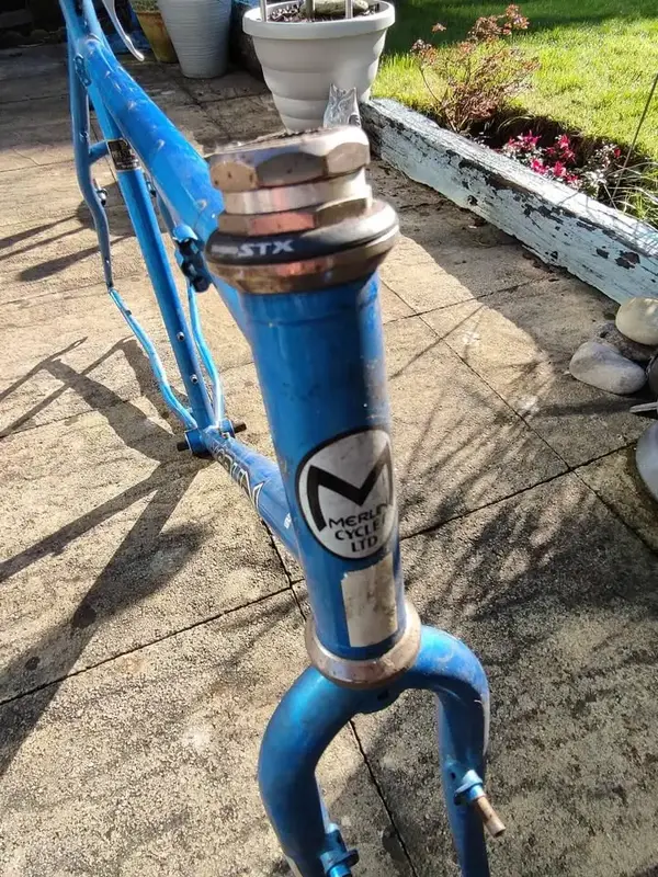

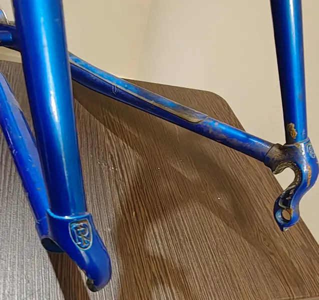

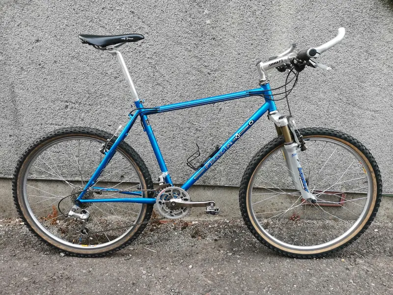

Bought this from a very affable man in London - thanks Frankie - you are a real gent.
a little pockmarked and in need of some TLC but no corrosion and a good basis for a build.
I recovered the cost of this one in Avanti refunds last week as both trains were delayed ( what a surprise!)
Now re-patriated 'oop north' where this one originated ( Ormskirk originally though Merlin moved to Chorley since)
2 hours spent removing old stickers and gronk - and a lot of paint restorer and t-cut later....

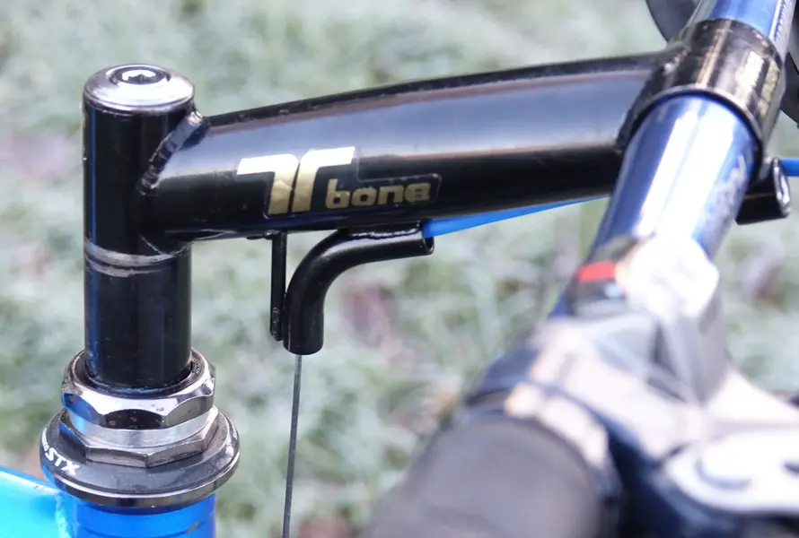

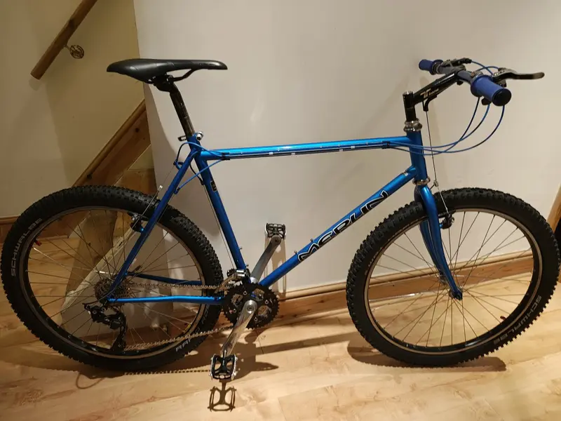

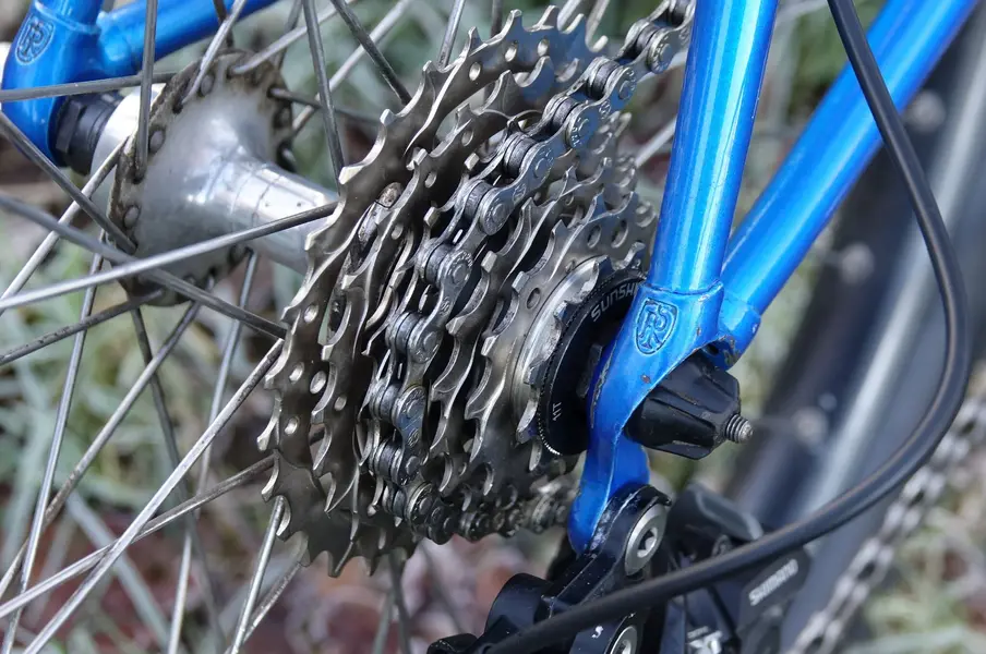

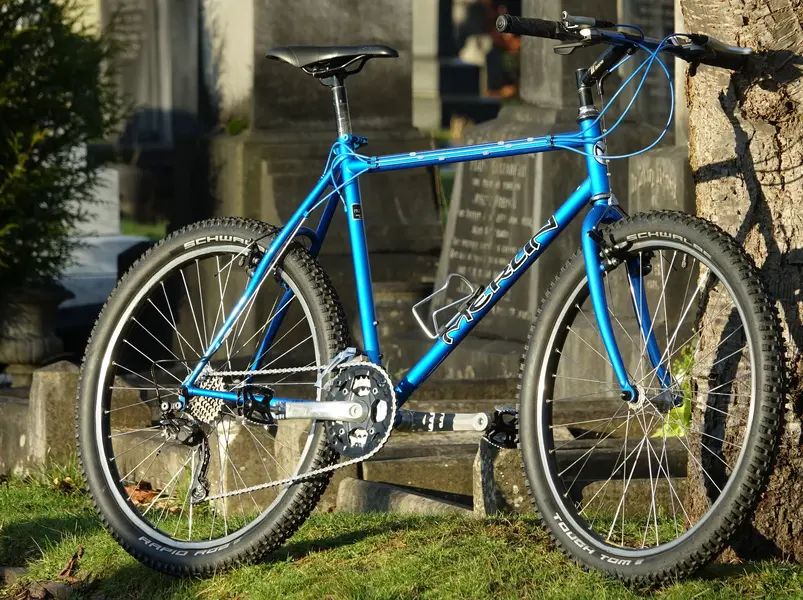

Given the nicely preserved frame cleaned up so well , I decided to build this one with all used parts and 3x7 drivetrain despite the weight disadvantage - it will keep the cost right down too which is always good and although it means a lot of metal polish and toil a little patina is sometimes very welcome
Parts list for this build - mostly from my own bin of items removed from donor bikes , but also some finds from the charity bike shop in Chorlton and some ebay snipes.
Original - Frameset, STX 1 1/8 headset (serviced, greased and re-sealed)
Replaced:

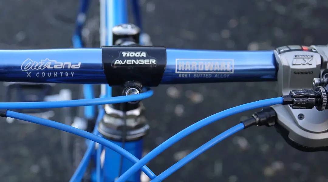

'2000s Deore LX Crankset, Shifters, Brake levers, Cantis

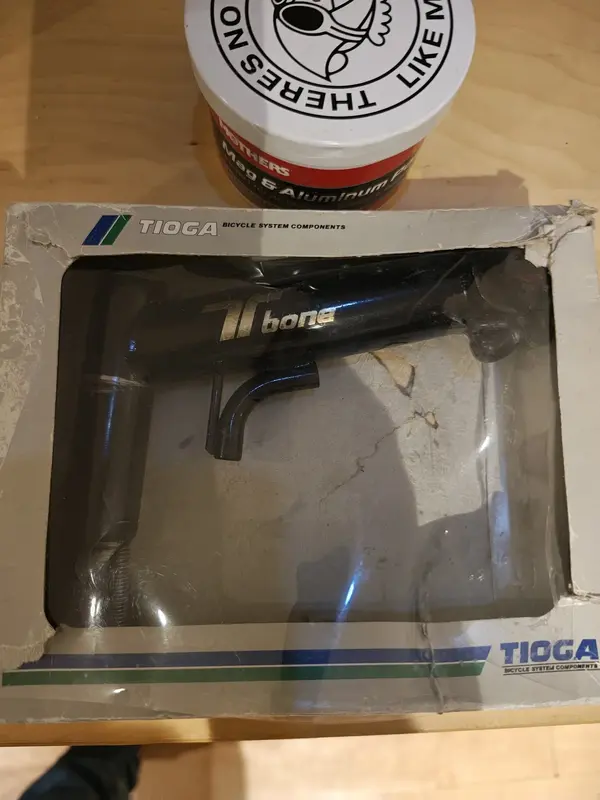

'90s Tioga T Bone Avenger (Tange Prestige) stem, Shogun seat post clamp, 27.2 seatpost
'2000s Deore XT skewers, Front and Rear Mechs, flat Bar
'80s Deore small flange hubs with Mavic Oxygen wide rims - 7 speed freehub body
'Modern' - new sealed bearing Neco square taper BB, Folding Schwalbe 26x 2.2 tyres, Selle Italia Saddle, 7/8 speed nickel chain, Sunshine freewheel, Canti cable hangers, cables. Pedals
initial build went problem free though the cable outers were a p.i.t.a.

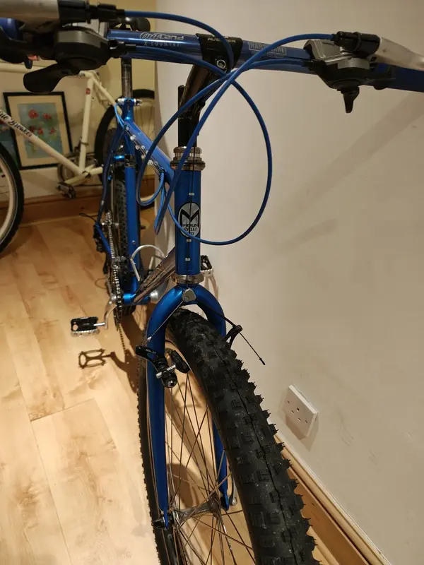

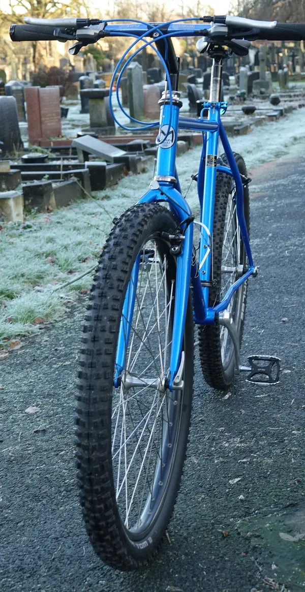

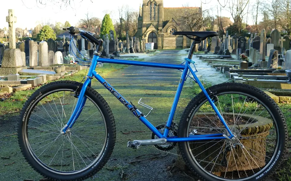

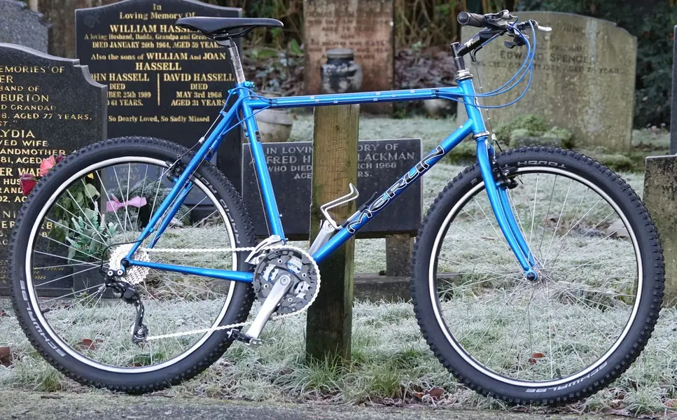

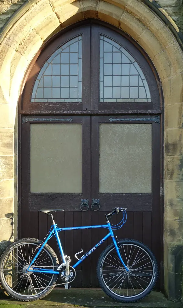

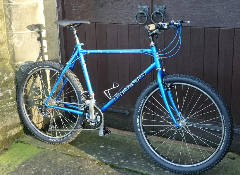

I didn't think it was ever going to stop raining last 48 hours but managed to do a brief shakedown ride today and get shifting/braking etc working despite icy roads giving me a bit of a scare DSC07475_cr.webp DSC07479_cr.webp DSC07485_cr.webp DSC07488_cr.webp DSC07489_cr.webp
