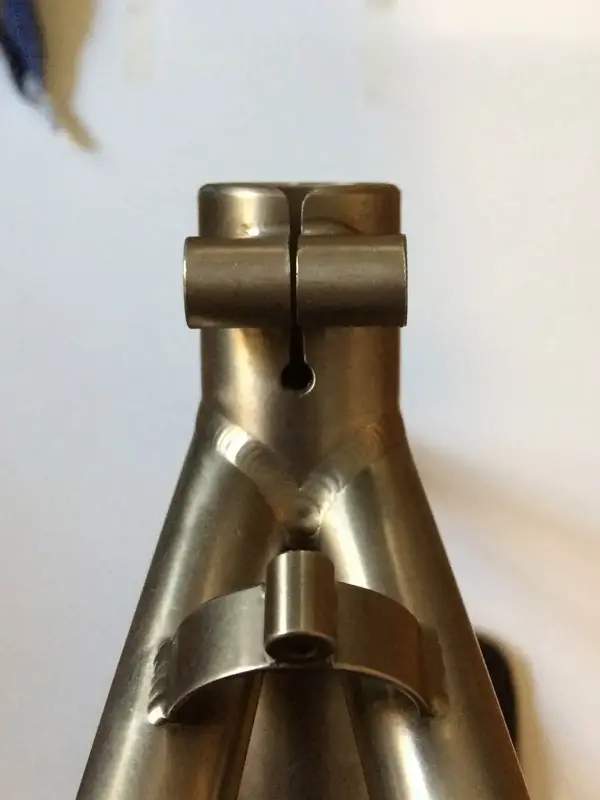

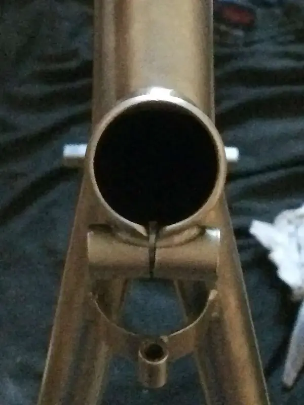

Attached a few pics of the seat tube area (sorry for the crappy phone pics). As with other ti frames there is a sleeve let in. It does not look like it´s aluminium, but also ti, welded on the top and machined down. That will make reaming a bit difficult. Before I cleaned it for the pic there were dirt deposits directly under the relief cut, indicating the seat post did not make contact with the inner wall downwards of the clamping surface.

Looks like the top section of your seat tube is probably a welded in machined extension, rather than a welded internal sleeve.
Something like this:
The joining weld could be hidden by the TT and SS welds.
There is plenty of material to ream it out (2.275mm wall on a 1 1/4" OD seat tube), as long as precautions are taken not to eat away or fold in the RH side of the relief slot while reaming. This means that it is unlikely to initiate a crack if it does need bending back out. On the other hand, a lot of force would be needed to overcome the yield strength, and it needs to be very well controlled, or the corner could easily get ripped off.
Probably better to try the post fit first.
If you take a seat bolt (probably M6 cap head), run it through the threaded LH half of the seat bolt fitting, insert a piece of thin sheet metal in the cut relief slot and tighten the bolt a little further, pushing against the sheet metal. This should gently open up the top diameter of the seat tube enough to insert the correct size post (27.2mm?), without taking it past the correct size.
As long as the seat post fit is OK and doesn't need work, remove the reversed seat clamp bolt and re-fit through the correct RH side. Tighten to correct torque, probably around 8-10Nm.
Ride the frame and use it as normal for a few weeks, keeping an eye on the area, then remove the seat post and look again at the fit of the top of the seat tube. It should have relaxed back to fit a bit. If not, then some more reaming or re-forming work may be needed.
Cross that bridge if you come to it...
All the best,

Thank you Dan for your recommendations. Glad to hear that the wall thickness would be sufficient for reaming.
Unfortunately there are no threads in the welded seat binder, it´s just for a through bolt. But it gives me confidence that it can be bent back without doing further damage.
Meanwhile I contacted an old family friend, who is a retired safety engineer for nuclear reactors and quite experienced with Ti tubing. He had no concerns about bending Ti 3Al 2.5V alloy. Turning a conical mandrel to insert into the pinched seat tube was his immediate suggestion. It sounded as if this would be the method "per the book". I´ll be at his place in a couple of weeks.
Thanks again for taking your time to respond and watch this space for the next post "mandrel stuck in seat post- advice needed" :?

Merlin used generaly 27.2 seatpost but sometimes, because the owner tightened too much the seatbolt, the diameter becomes smaller. When Isee your pictures, it's what happened to yours.
But there's a solution : take a tube around 25mm dialeter. Put it in the seat tube and turn with big movements front and rear and right and left: the idea is to open the diameter. When it's Ok, the two screw cylinders will be aligned .
I did that on my 2 Merlin Frames :D
Yes the frame came with a 26.8mm post mounted :evil:
If I had to open it up just a little I probably would have a go myself, but it is quite a bit deformed. I´ll have the specialist look it over, I´m not in a hurry.
