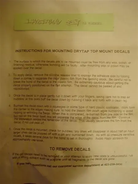

Here you go.
Damn you and your fancy know it all envelope!!!
Bet it's not a self sealer though!
:lol:
This is the second time these old Merlin instructions have come in useful, last time was for Wu, glad I didn't delete the image!
:D
http://www.faqs.org/faqs/bicycles-faq/p ... on-30.html
be careful, these old decals are extremely fragile and stick very well to the tube. no chance to correct if placed wrong. and make sure that they are fully rubbed on before you try to remove the backing paper. if a part of the decal still adheres to the backing paper it will tear apart.
but check first if they are still sticky as they tend to dry out over the years.
good luck!
Carsten
