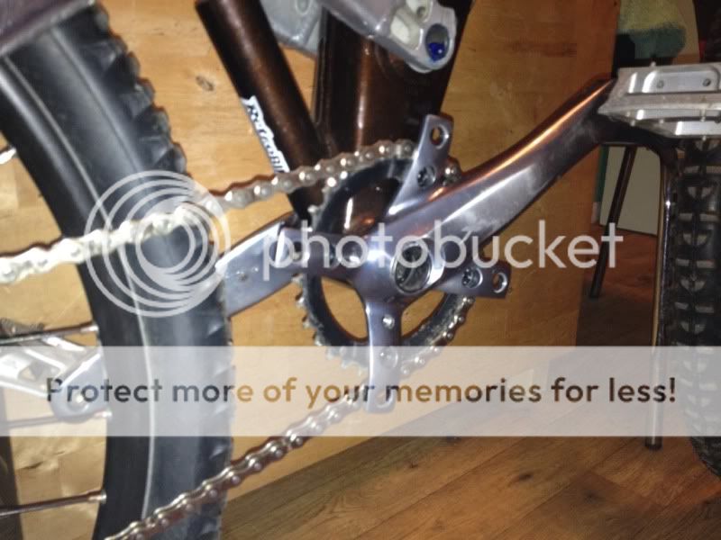

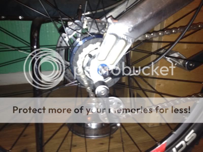

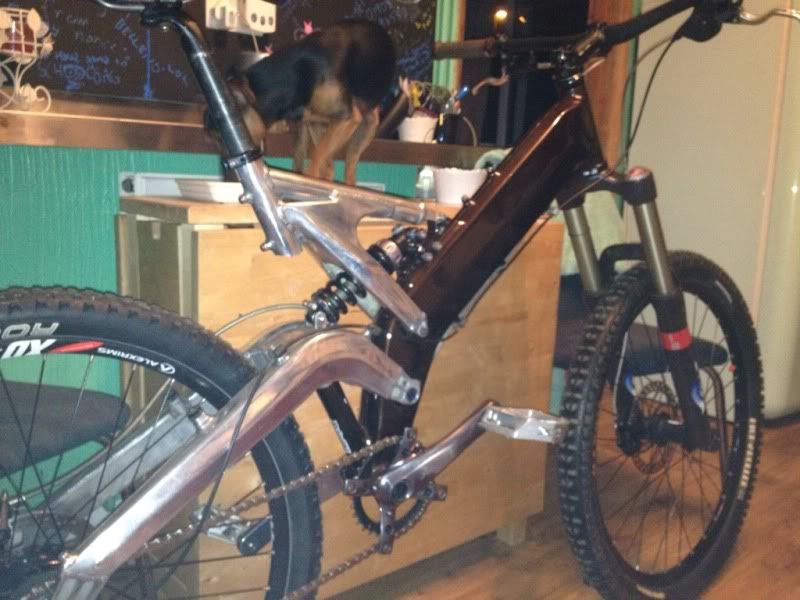

Got it rideable tonight. Only went for a blast round the block but she feels lively. Light enough to throw around. The alfine seems to have a nice spread of gearing. Got hold of an xtr crank that I'll do the jonesey mod on once the 102bcd ss specific ring arrives. Due to the suspension I can't get enough tension pushing the chain up so I've had to push it down. Not much wrap on the rear cog but doesn't slip. For now I'll dial it in and see what improvement can be made.
