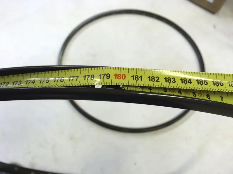

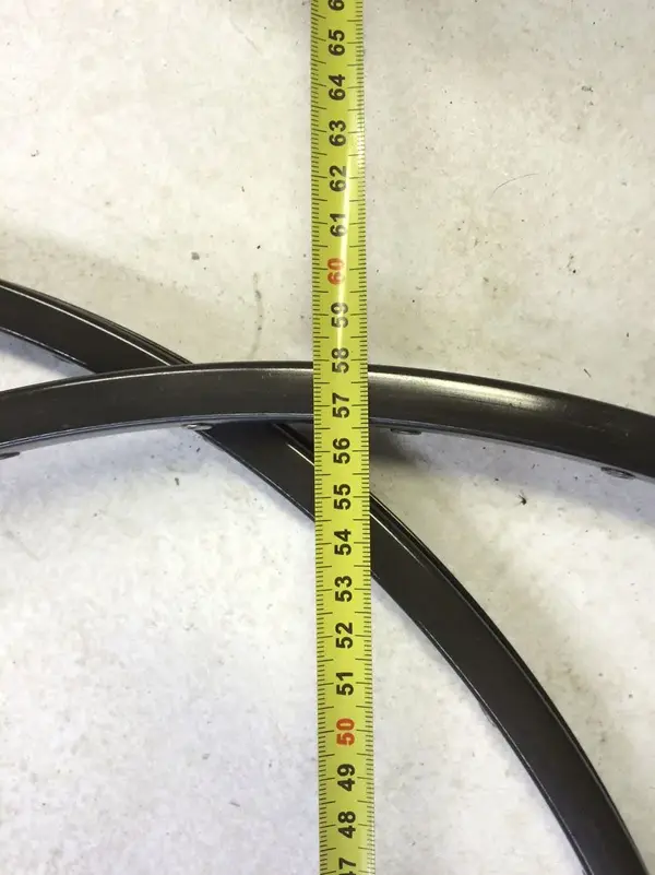

A pair of rims, new, never used, what looks like 650C size. I bought them thinking it would be 26" for a MTB, but they ain't....

could be interested by the rims but 650C is supposedly ( thanks to Sheldon) 571mm as an outside diameter !
so does not match your "about" 580mm pic :?: can you recheck ? ( A is 590 , B is 584 )

could be interested by the rims but 650C is supposedly (thanks to Sheldon) 571mm as an outside diameter!
571mm is the bead seat diameter, i.e. the diameter of the wire bead of the tyre, just under the hooks of the rim. They look like 650C to me.

then they should be 650B, measured them again, it's 583mm, so that should be 584mm i guess...
i'm sorry....
Re: Mavic MA40 rims 36H, 650C ?, Dura Ace RD M7700
the depth of the bead is 0.6mm, so 583 minus 2x 0.6 is.....571mm!!!! So it could be 650C...
thanks Jim!

To look at it another way, 1800mm / pi = 573mm
I think that's close enough to be sure they're 650C. 650B rims would measure more than 30mm larger in circumference.
