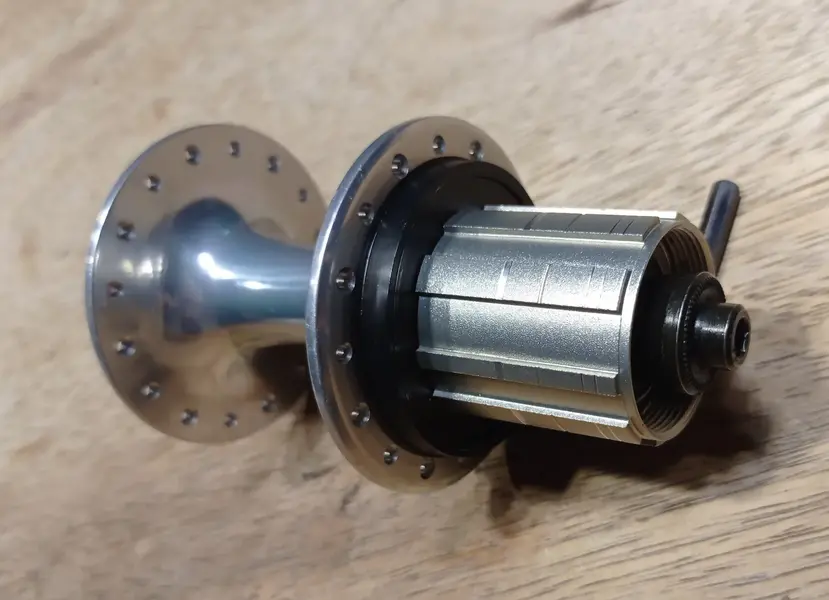

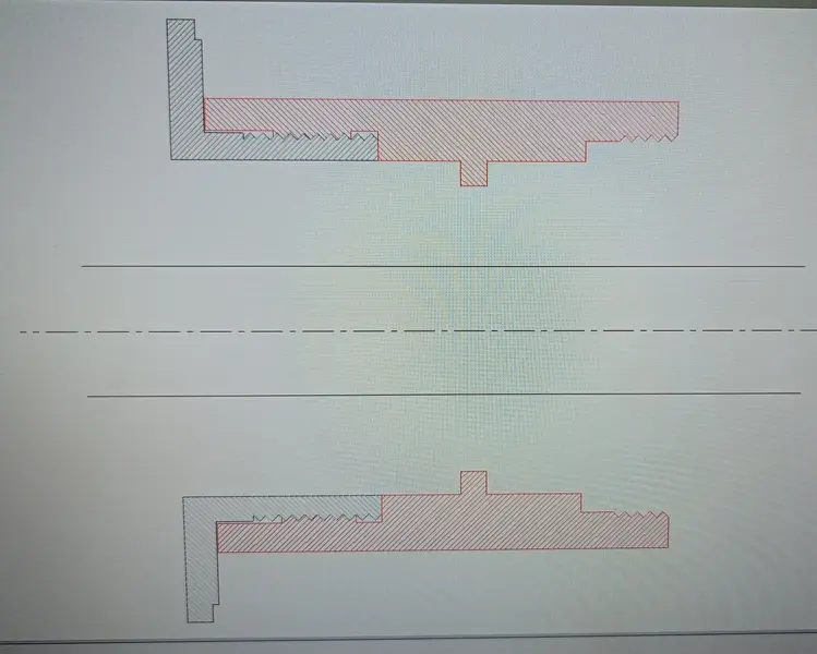

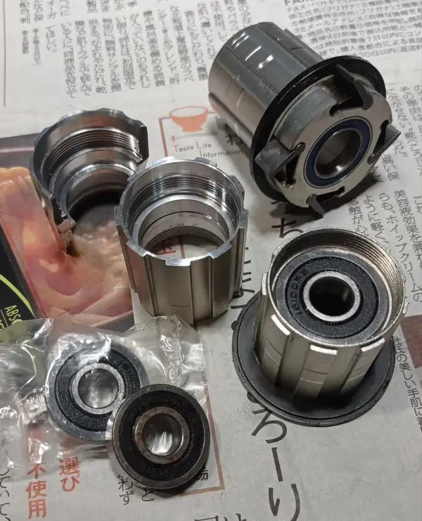

I found a some Powerway bodies in my stock that placed the bearing in the right location relative to the shell end, so I had them remachined to fit the mavic drive plate. By using a 16100 bearing, I could use the 28mm bearing bore without sleeving and recutting that area.

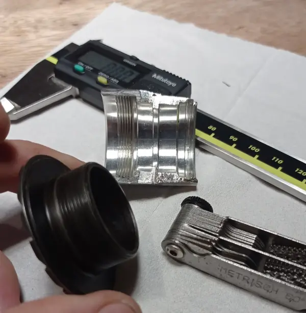

In the photos below you can see a section of the original half moon drive sleeve and an example of the donor freehub body.
An added advantage is the ability to use an 11t small cog. The original HG bodies fit 12t unless they were recut on the outside edge.
