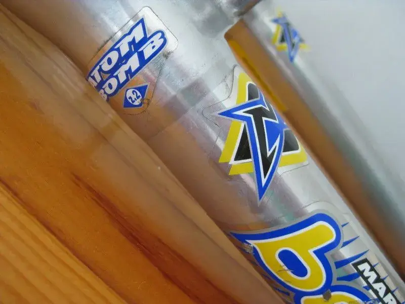

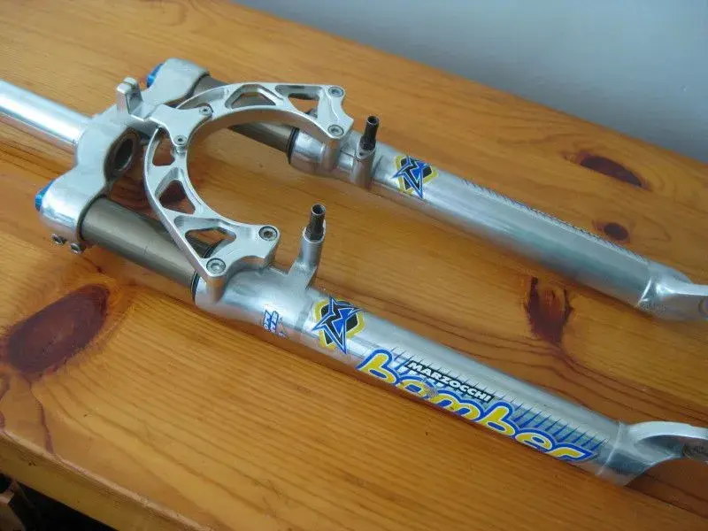

Took a couple pics for good measure. I don't think you can tell in the pictures but that crown steerer is not original. The previous owner managed to knock the press fit steerer partially back through the crown. That is a new full bolt together crown/steerer assembly. Missing the fork boots in this picture as well.
Oddly enough after reading down to the start of that MTBR thread and looking at the pictures posted by the OP it is the same fork as mine.

the decal style on yours match the ones on my black fork. neither of my atom bomb, or super fly came with a crown with the removable steerer. i do have a regular z2 that does. not sure which fork was supposed to come with which type of crown, but the crowns can be interchanged between the same generation bomber forks.
none of my forks came with fork boots either.
