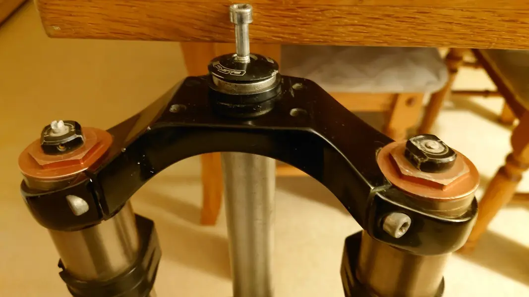

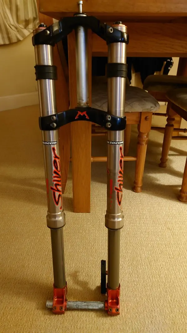

I'm getting some parts together for a downhill bike build and got myself a cheap pair of Marzocchi Shiver DC. They also came with a whole bike, a 2004 Norco Shore, not sure if I'll use this frame yet though.
They look to be in quite good condition over all but the bike they were on was left outside for over a year. They are missing the guards and one of the adjustment screws on top has broken.
I'll need to give them a service but I've never serviced a fork before. Is it easy to do and what oil and amount do I need?
I might be able to live with the broken adjustment screw but will look out for a replacement cartridge. It's annoying as some just finished on eBay but let me know if you have one.

Skf MTB35M green seals are amazing for the shiver. Stock oil is golden Spectro 125/150. A quart will be more than enough, also slickoleum to pack grease into the void between the dust & oil seals is highly recommended. Just did a rebuild with the stuff above, zero stiction.
Oil quantity: http://marzocchiworkshop.blogspot.com/p/oil-quantitys-and-levels_858.html?m=1
For the adjuster you might just want to try and slot it, just enough to turn, finding a damper may be expensive and difficult
That's excellent information, thank you. I was thinking about cutting a slot in the adjuster as a temporary solution, some cartridges sold on ebay last month for £50 the pair so the do come up for sale occasionally.
