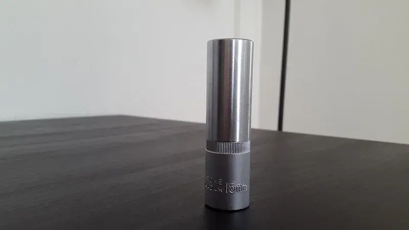

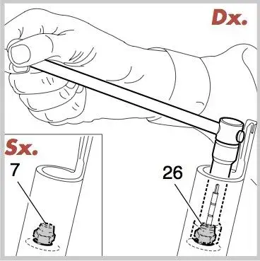

I want to service my marz z2 air from 2000. and I am having troubles finding appropriate tool to unscrew bottom screw from the right leg (the one that has rebound adjusting rod).
The rebound adjusting rod is to short on this pic...but whatever.
I have this deep wrench but it is too short for this job. Any suggestions, maybe ebay link to appropriate tool...I would really appreciate it!

to remove the bolt you'll need an extra long socket..
looks like youve tried this already..but there might be an even longer one somewhere out there..
or you can get whats known as a pass through socket and ratchet
it probably wont be cheap though as it uses a different way of mounting from the ratchet to the sockets compared to normal socket drive systems..
so youll need a new pass through ratchet.. correct sized pass through socket.. and probably a pass through extension..
you might get away with just a pass through extension and socket though if you can bodge something to clamp onto the extension and give you some leverage.. or you might also chew up and knacker the extension if the clamp doesnt fit properly.. :lol:
