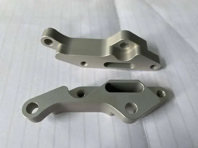

This Disc Adapter Formular (FS) to IS Mount is for older Marzocchi's like Z1 & Z2 from 1996+.
I solved this problem now by doing this well known adapter as I have a box full with orange Marzocchi Z1 from the beginning and people contantly asking for it 2-3 times in a month. Not that mass seller product, but I like to fix problems. 🙏🤣
I needed some years to get a master sample, but here it is : Made out of Aluminium 7075, HQ CNC maschined, anodized. May not fit perfect to all Disc mounts, but it is a comfortable base to make your Z1 running on disc just by little changes!
==> https://dr-zocchi.projectweb.de/disc-adapter/
