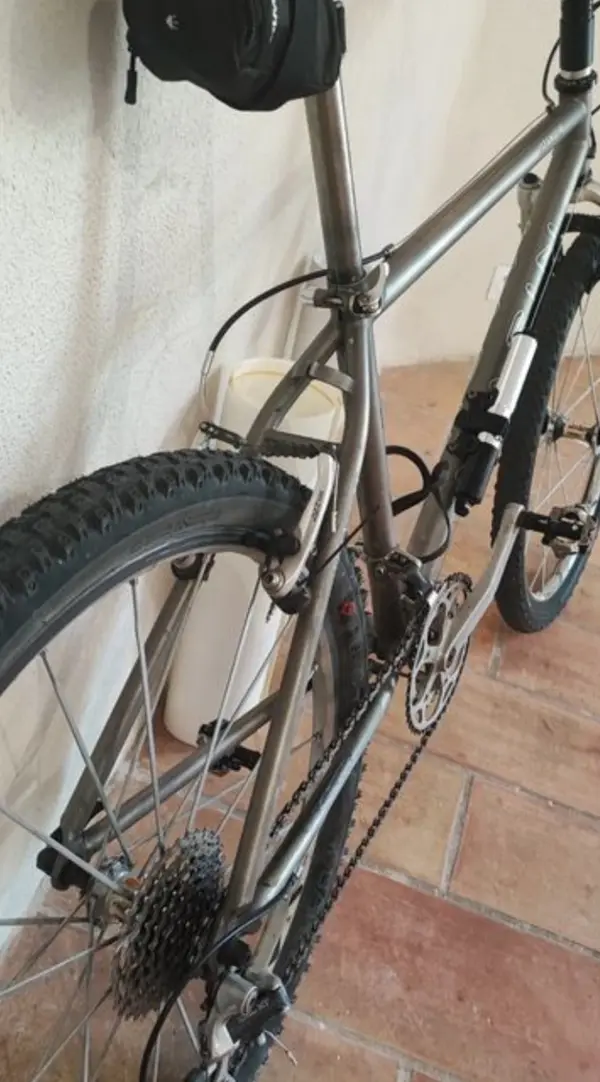

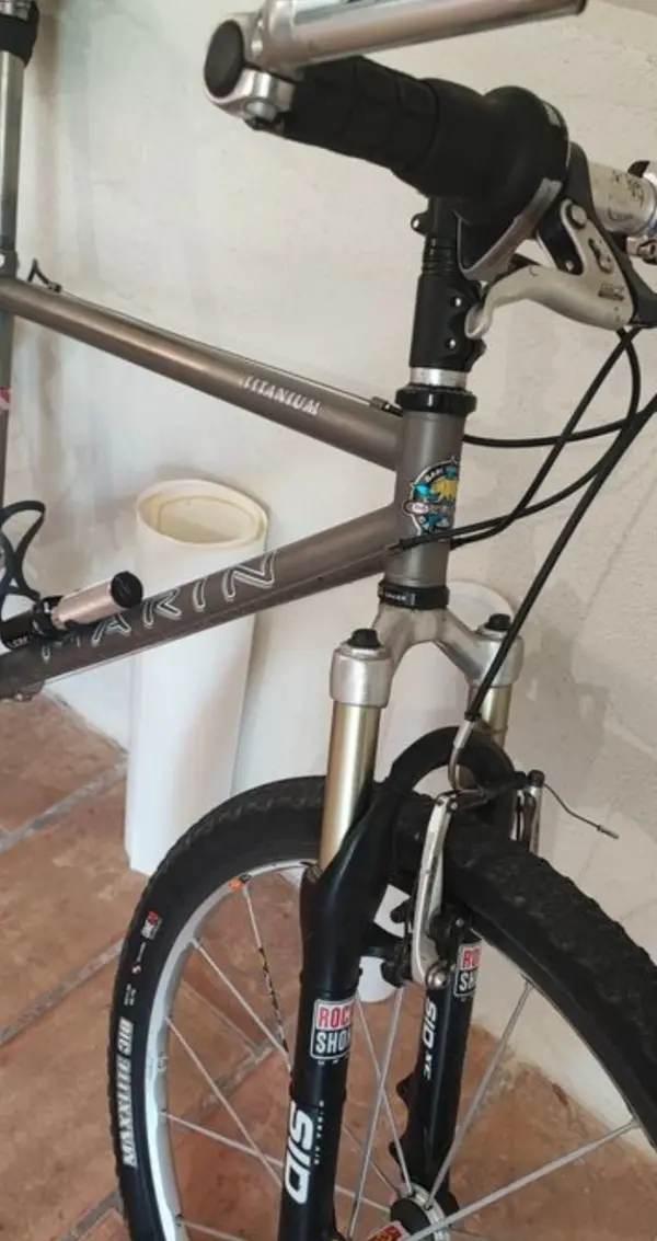

I just picked up this Marin Team Titanium, in pretty much sparkling condition, very little use. I'd like to fit discs to it, obviously easy with the SIDs on the front, but no bracket to the rear.
Question: one of those bolt on rear conversion kits possible, and 1. Is it effective as a brake, and 2. Is it maybe too much stress on a Ti weld/joint to be worth it?

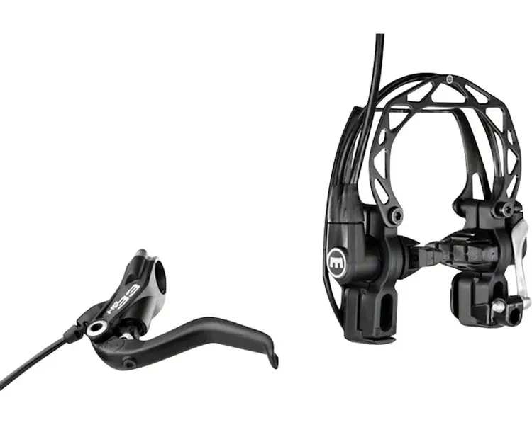

I wouldn't risk it on a ti frame tbh. Usually there are reinforcements on the non drive side for handling the torque, which this frame is lacking. There are different conversion kits too, which can be mounted on the brake boss at one end, maybe the stress is splitted better using them, but i'd just go with the best possible v brakes on this. Something like xtr952s, Avid arch rivals, or Magura race lines.

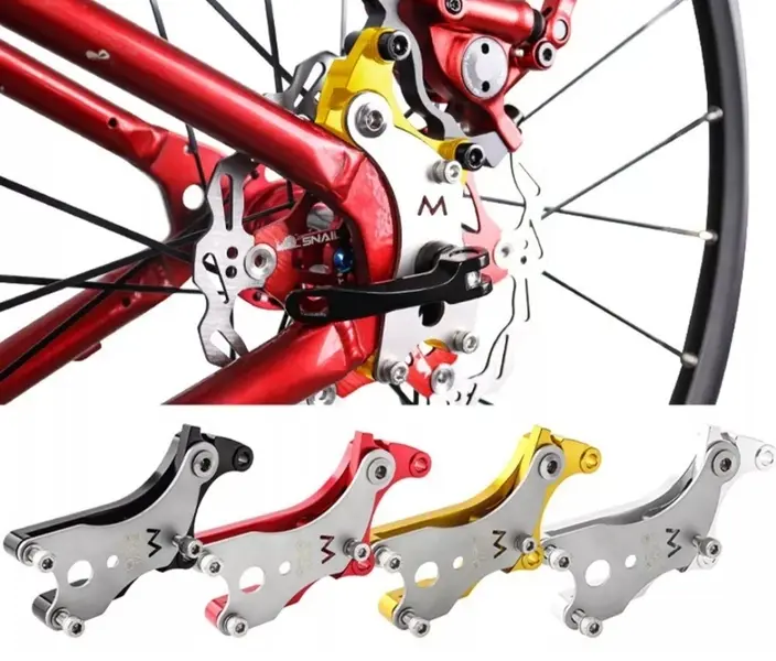

I think those on the pics you've attacched are not fitting this frame, anyway. For light use some top shelf v-s are fairly enough imho, they can be surprisingly strong with the right pads, levers, and alignment ofc.

Same frame as mine; so nice.
Normal centre-pull canti's can be very powerful when setup nicely. Discs would be sacriledge on such a machine. (my opinion obv)

I know where you're coming from! But this would be a runaround for me. Not a pub bike (I've got a Dawes Kingpin for pub duty) but something to bomb about the lanes and tracks on. Discs would be a challenge, but I do like the stopping power...
Considering this for a solution

I agree that it is a risk, it makes the bike ugly and for the use you have decided to give it, the discs contribute little.

I love the Magura brake rims, they are also very progressive and have good braking. But in my opinion they make thin tube bicycles ugly because they are very lumpy. They are also a nuisance to remove the wheel and adjust them the first time so that everything is in the right place and equidistant. It is laborious, although this last point depends on how "maniacal" you are with perfection.
