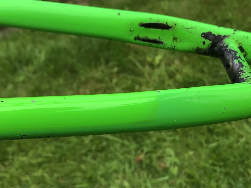

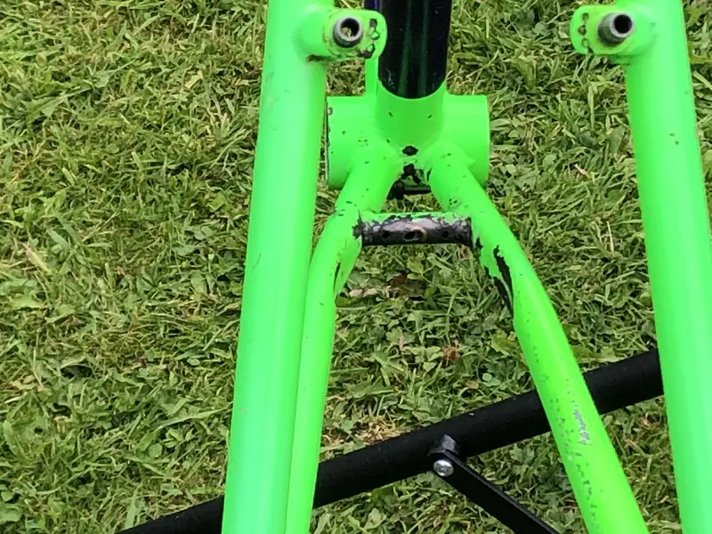

Have you considered a coat of t cut. It will bring the zing back to the paint. As for the krust, you will need to put something over those areas in the long run. Prep is everything with paint...
Looks like great progress

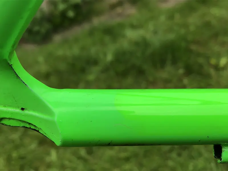

I gave it a once over with T Cut, polish rather than the paste ( if they still even do that? ). Polish is way less abrasive than I remember the stuff that used come in a tin was. The polish barely touched the fade in the paintwork, at least it shines now.
Been a while since i painted anything with aerosol, last thing was a 1978 Yamaha RD250, about 10 years ago, it looked OK just not as good as I'd have liked.
The areas your missing are pretty hidden. You could probably get away with humbrol enamel in a roughly matching colour.
Paint is all about prep. Kill the rust, rub it down, prime it, paint it, clear it. No drama.

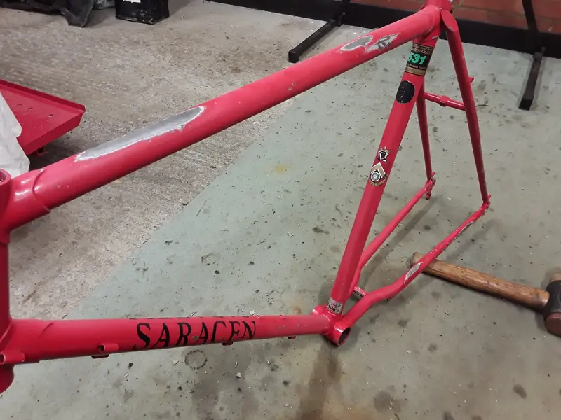

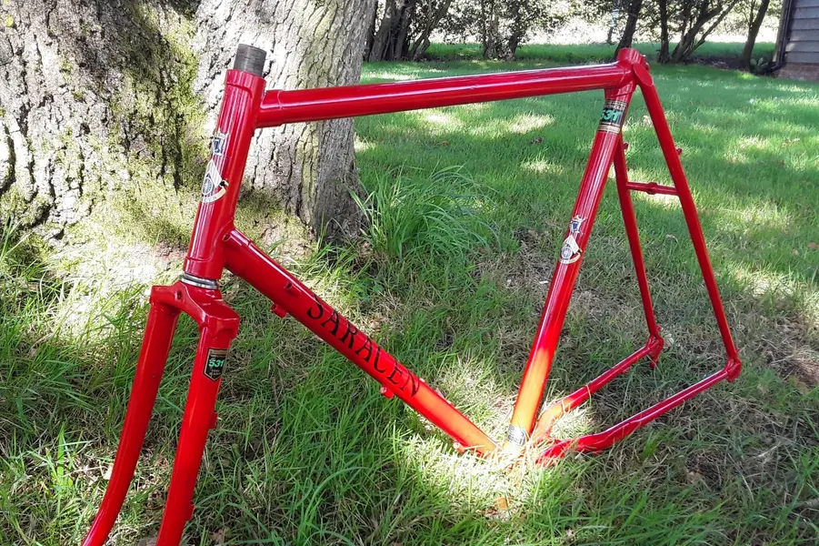

I touched up an horrendous frame with enamel and a brush not long ago. Whist its not a respray, the results with a bit if patience, can be very good.
Before and after....it was just signwiting enamel mixed to roughly the right colour and cleared over the lot....

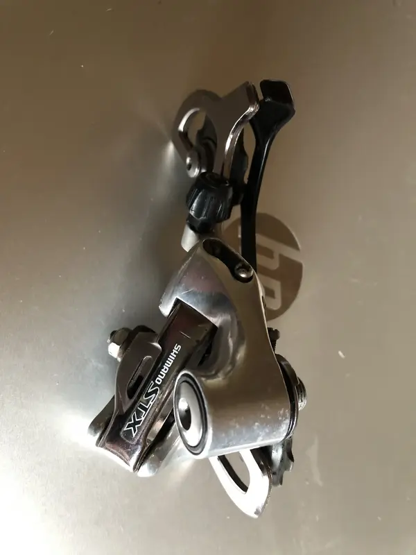

3 deliveries today, very shinny new STX FD, Set of rigid forks (Impulse buy), and a Pulsar hub / Mavic Rim wheel, to go with Ritchey headset that arrived yesterday

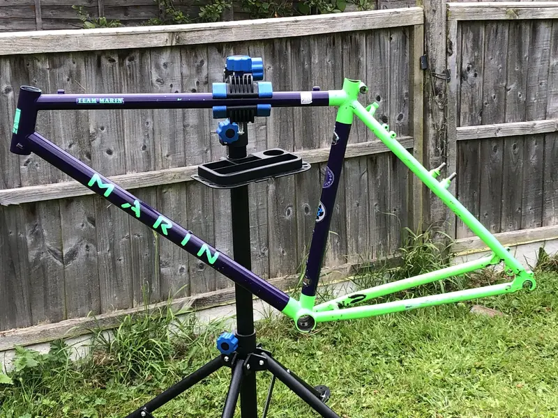

Now I need to pull my finger out and either commit to re-painting the rear ( green ) part of the frame, or preserving the scratches etc leaving it as is.

Prep'd the brake lever bosses for ready for paint.

Have rubbed down the stem and put a coat of primer on, forks also primered and a thin 1st coat of paint done.
As it's stands t he bike is going to be a lot more period than I originally intended, albeit with mainly STX running gear ( everything except frt wheel and cantis ). Probably won't look for a set of STX Canti's though
