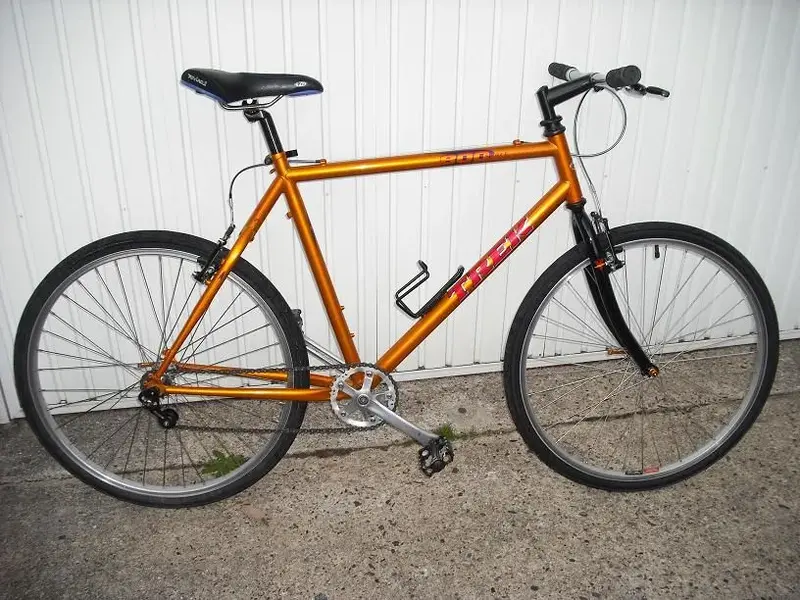

Hi, i built this as a single speed commuter bike, i found it very easy and as long as you follow a few basic rules all works out fine. Schwalbe City Jet tyres are perfect for a town/road commuter bike. single speed keeps things simple, hope this helps,
Jussa :)

I did very much the same with a trek too..
not sure if yours would take 650 or 700 tyres, you 'd have to check clearances, not to mention adapters for the brakes. I have the 1.5 city jet slicks on too and they're pretty quick, especially with a 42:16 ratio
