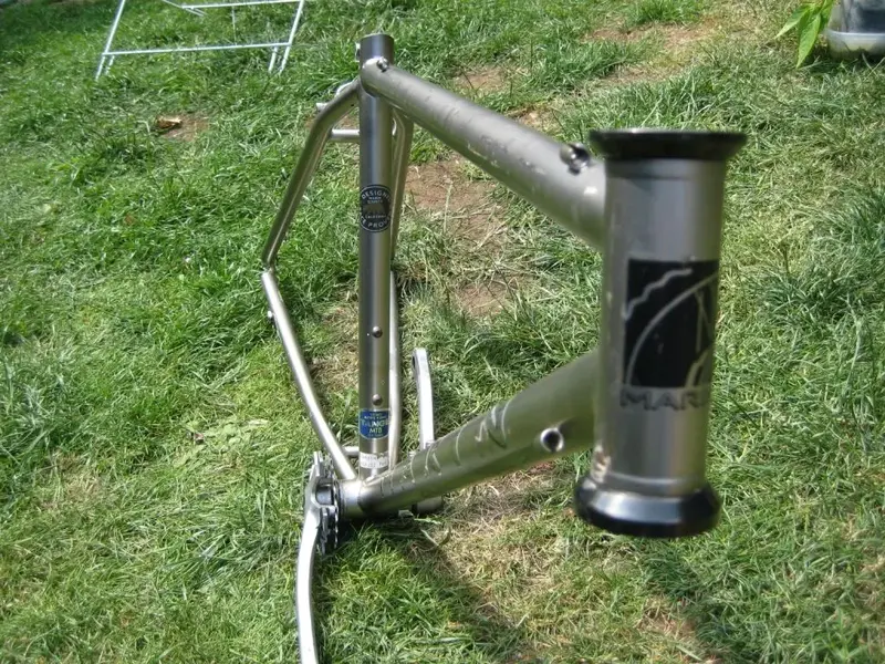

First question is exactly what year it is from. The Manitou Magnum forks are I believe '95 model year which dates it around then but hopefully some of the Marin guys on here can confirm this from the colour scheme.
Next question is whether it would be possible to get some replacement stickers for the frame. The paint is in pretty poor condition so I am respraying some sections of the frame. I got myself some Vauxhall 'Platinum' paint which is an almost perfect match-not bad for a bit of a guess in Halfords. It would be nice if I could replace all the stickers and respray the whole frame, otherwise I will mask off the headtube, seattube and downtube stickers left on the frame in the picture below.

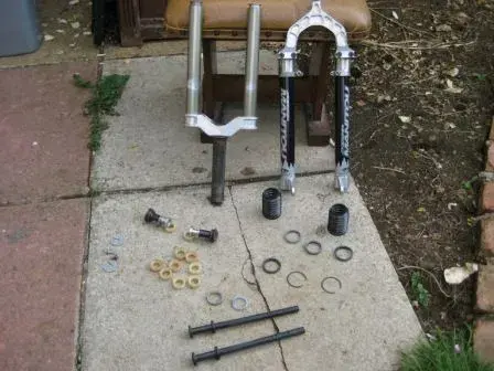

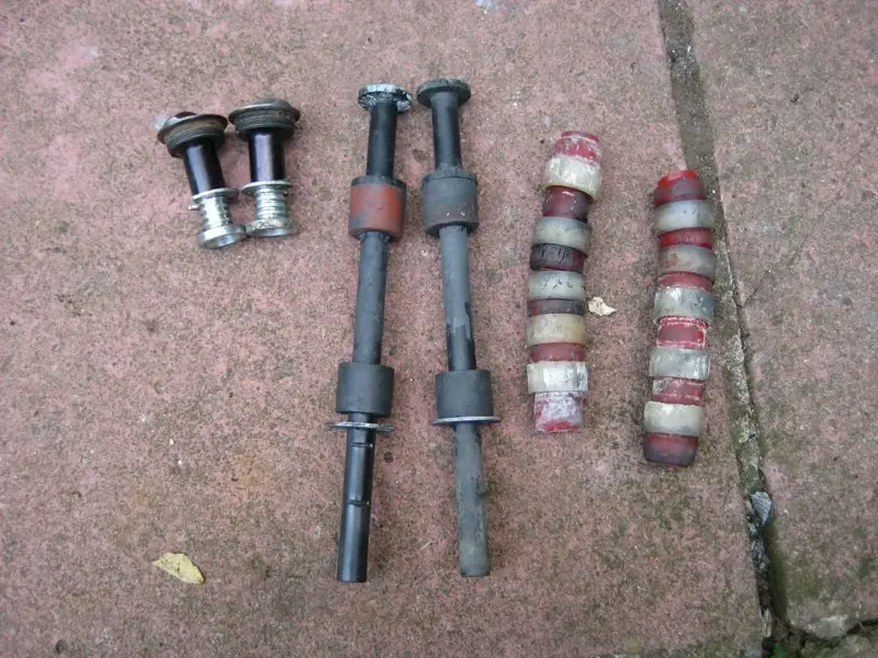

The forks are also being rebuilt with new elastomers as they were all cracked and/or squishy. See picture.

It's a 1994. They are gorgeous light frames, and can build up (with a rigid fork) to a 22lb bike with no great difficulty. 8)
Gil_M on this forum is your man for decals.
I resprayed mine (owned from new) years ago in a custom colour. :D

Just a quick update. The elastomers arrived yesterday from the US, so today I cleaned up all the parts of the fork which are staying. I did get a bit worried about the condition of the stantions, with considerable wear through the anodizing where the bushes rub against them. Ah well, I have the elastomers now so I'll put it all together and keep an eye on it. I'm sure replacement stantions would be impossible to source as Manitou have stopped supplying even the elastomers, so I suppose a new fork will be needed in the future.

Has the dropout been repaired? Looks like a burly weld but may be the light in the photo?
Nice frames these.
The drop out looks exactly right. It's socketed, fits into the ends of the stays and is brazed not welded if I remember correctly.
