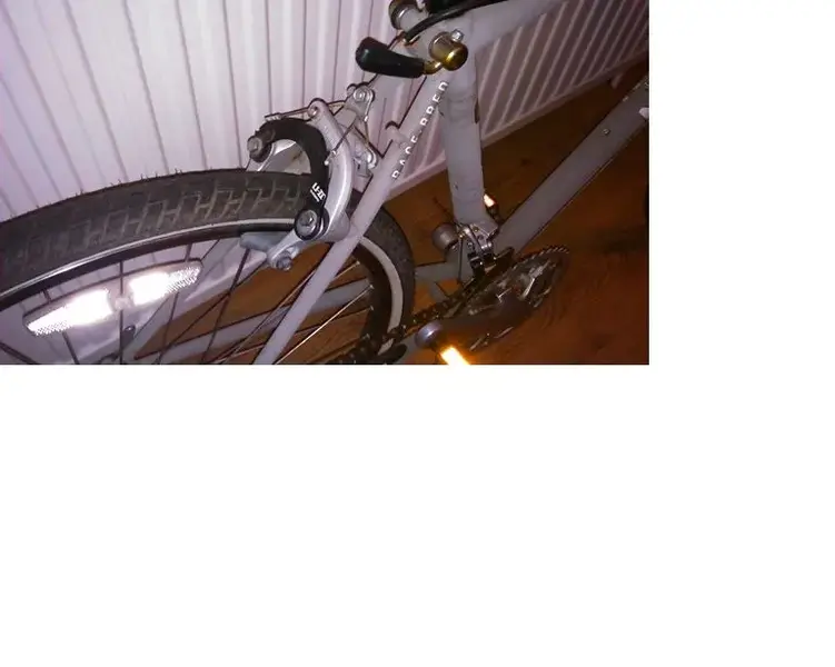

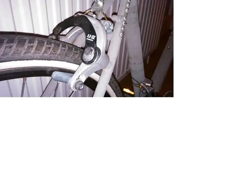

I would ask then that somebody may be kind enough to share their wisdom as to why my, what I believe to be a 1990, Marin Pine Mountain has a U brake on the rear seat stays?
Sorry about the poor phone camera images, I will upload some better ones when I get chance.
Judging by the paintwork - light grey zolatone, and the groupset - full DX this should surely be a 1990 but all examples I can find have cantis front and rear. The only U brake equipped frames seem to be earlier. Could this be an example of using up old frame stock or is this a common set up and I haven't dug deep enough?

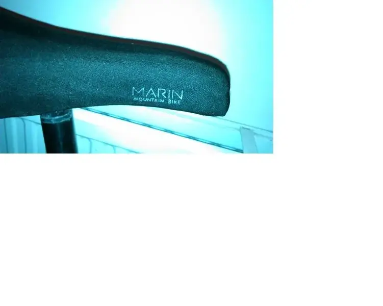

Also the saddle seems to be earlier than other 1990 models I have seen (it's a sort of thick lycra clad affair). Apart from the tyres (period specialized) I reckon it is full factory spec even down to brake pads, apart from a few rust spots and storage marks it is in pretty good nick. I don't think it's done more than a couple of hundred miles as it seems mechanically spotless.

Hi,
It seems like a genuine enough 1990 to me. It's kitted out right and has the patina of a bike 'that' old so, unlikely to be a re-badged something else.
This odd-ball thing is found in early 90's marins, quite often. where i can envisage how..."boss, we have 46 frames left over from last production, shall we put them through as this years?"
Taiwanese frames without a serial number of coat of paint could be anything else!
Possibly a mistake, experiment, or quite deliberate to see if u-brakes are still called for. who knows?
Either way you have a good nick pine mountain with a freak u-brake. Can only be a good thing!
cheers.
Hi,
Thanks for the reply. When I got it it had panniers and mudguards on so I reckons it's only had occasional commuter use over the past 24 years!
I quite like the u brake, it works a treat, although I think it has been snapped/ modified at some point.

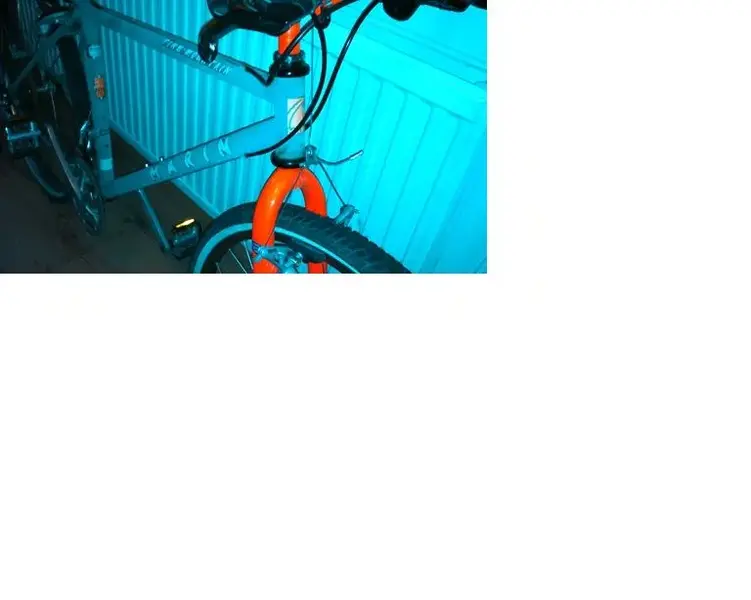

Ooh, that's a nice one!
Could it be an '89 bike? The Zolatone looks light enough (but that could be the camera flash).

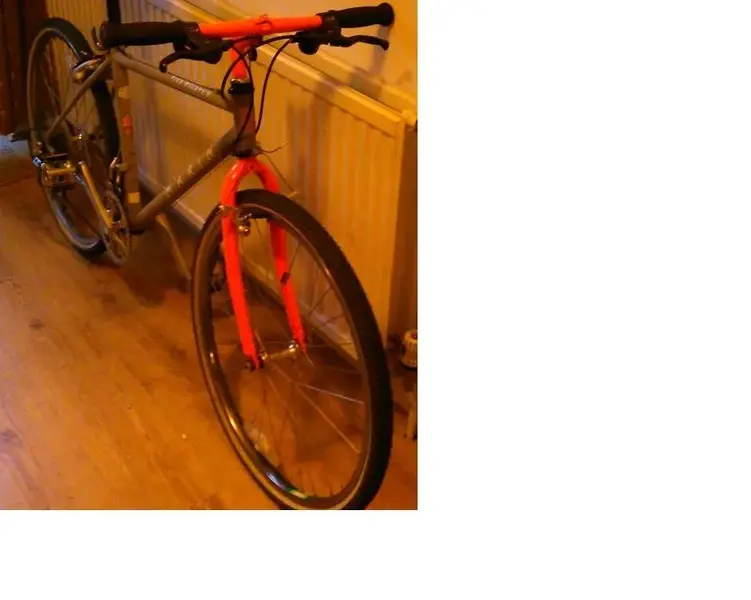

When you're done with the rebuild let's see that orange in daylight. :D
Brilliant, cheers on the o rings. Weather permitting I'm going to make a start on stripping down today. I'm eager to try and get the shifters running smoothly.
I had a quick polish of the front wheel and it's come up lovely. Hopefully the rest will follow suit! I'll post some more pics along the way. Apart from a few chips the forks are pretty bright, I don't think it's seen the outside of a shed in a few years.

Stripped down the front end and found out why the bearings sounded so nasty - a cracked crown race! The rest of the DX headset, including bearings, looks to be in good condition so hopefully I can source a new part to suit. I forgot how huge the bearings are!
The steerer tube is stamped 1989 which would maybe back up the 'old stock new colour scheme' theory for the u brake.

I know that the smallest size (15"?) 90's had a U brake as my mate had a Palisades with one bitd. Yours looks bigger though.
Defo a 90 paint job as 89's were gloss grey with colour matched and slighty different decals. Another pal built up a 1989 Palisades the other year but that had rear canti's. :?
