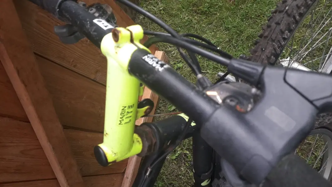

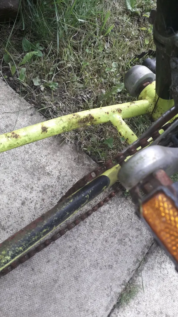

Man, the BB turned like hour-hand increment and the headset didn't move at all! Been outside for 10, maybe more years. Every nut and bolt has fought back.

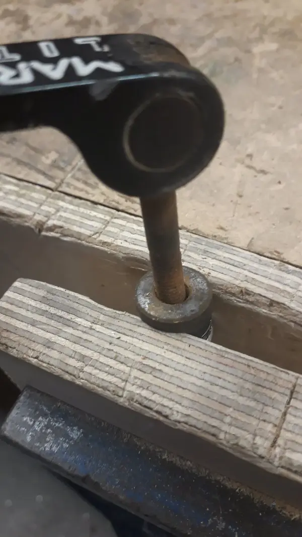

I had to take the bike to work and use a heavy bench vice to turn the stem with a brush handle.
The BB is still in but, not for long. Even the seatpost quick release gave heavy resistance.

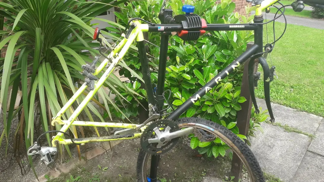

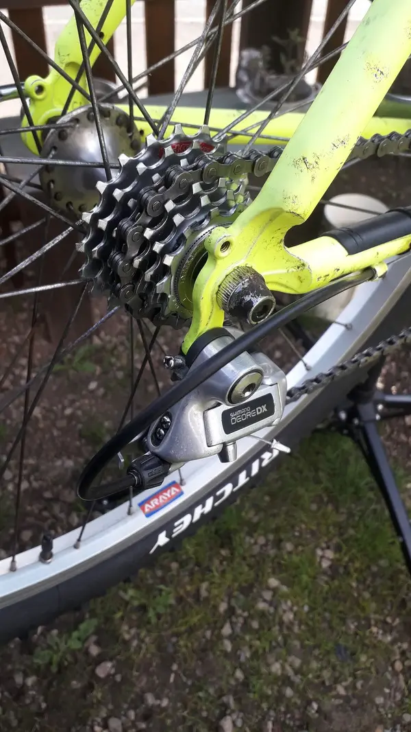

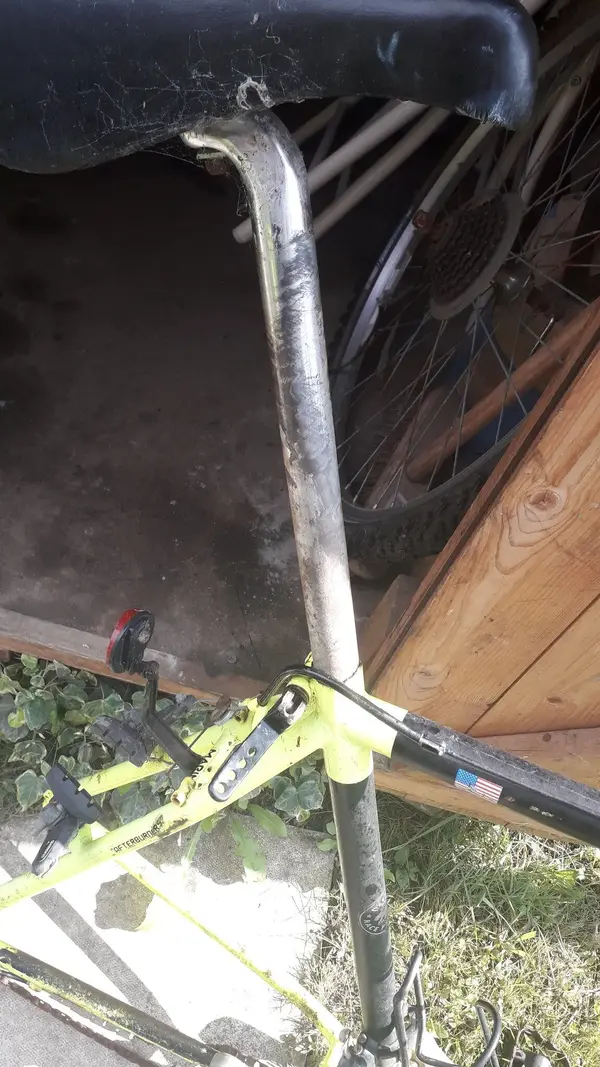

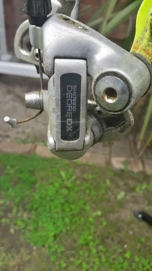

Well, a dx rear mech is always welcome and the seatpost (despite the lowest possible position/time outdoors) just shuffled up no bother. I've loads more to do and have no pressure to finish it.
20210817_142014.webp 20210817_135444.webp 20210818_122415.webp 20210818_122006.webp 20210816_155327.webp

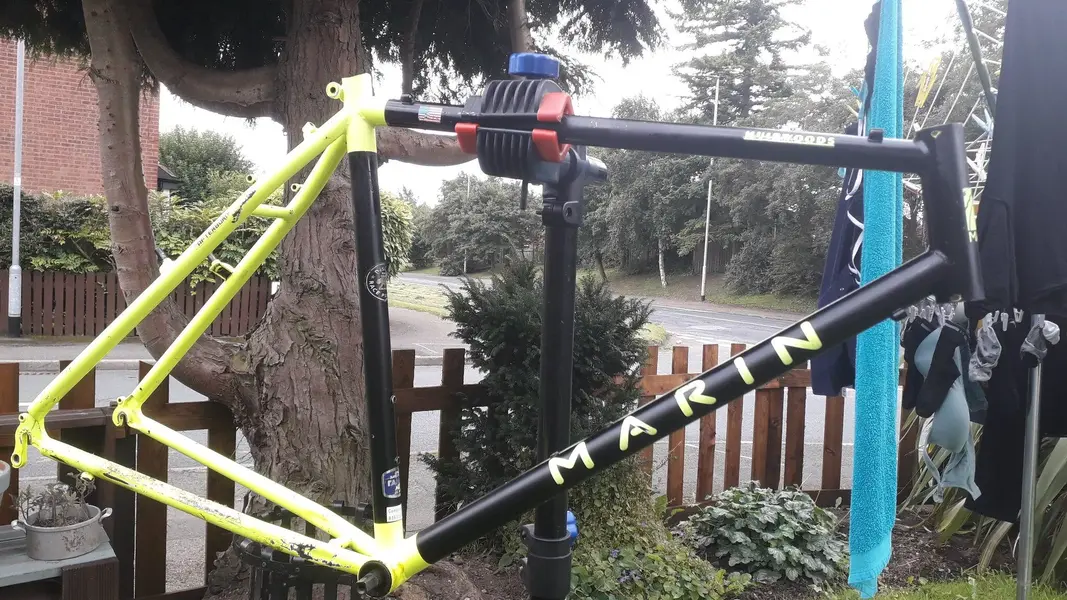

I will keep busy with the frame and forks. A multi-stage thing I have going on where I de grease, lightly scour with GT85, rub in some heavy libe to seal and shine.

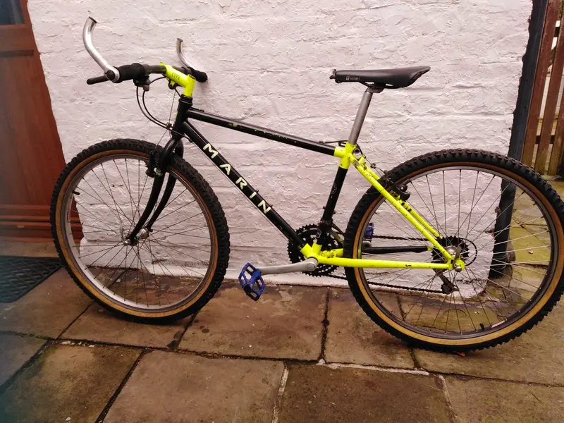

A bit more attention paid to the frame. It's as good as I can the paintwork without over restoring, I dont mind a few scabs and paint fade. All things considered.
I have hit some small jobs such as the headset. Hated binning the original ritchey logic but, it was buggered. A new, cheapo headset had been fitted.
All about the fusilage for now as I dont want to get ahead and loose focus as a sympathetic restoration is the order.
A sharkfin (to cover damage) and cable-rub dot thingies are on their way.

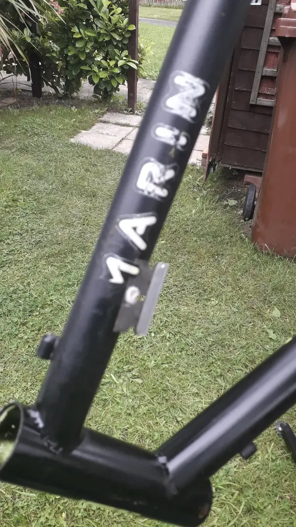

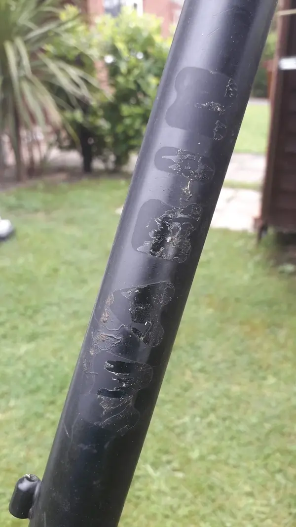

At point over the years, someone replaced 'muirwoods' with some fork decals, had to go!
That's better.

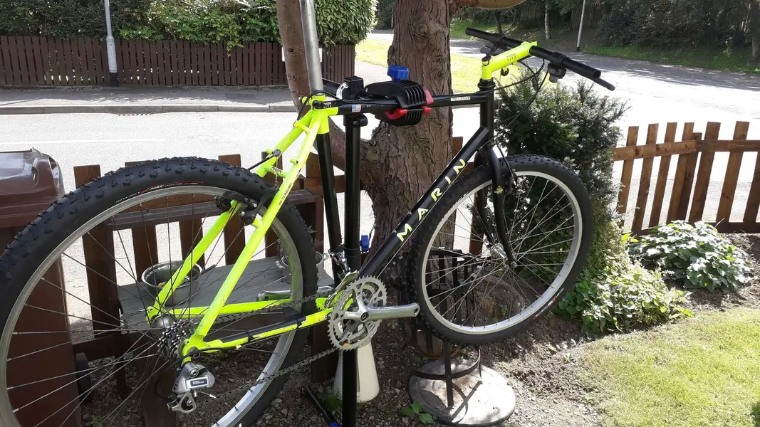

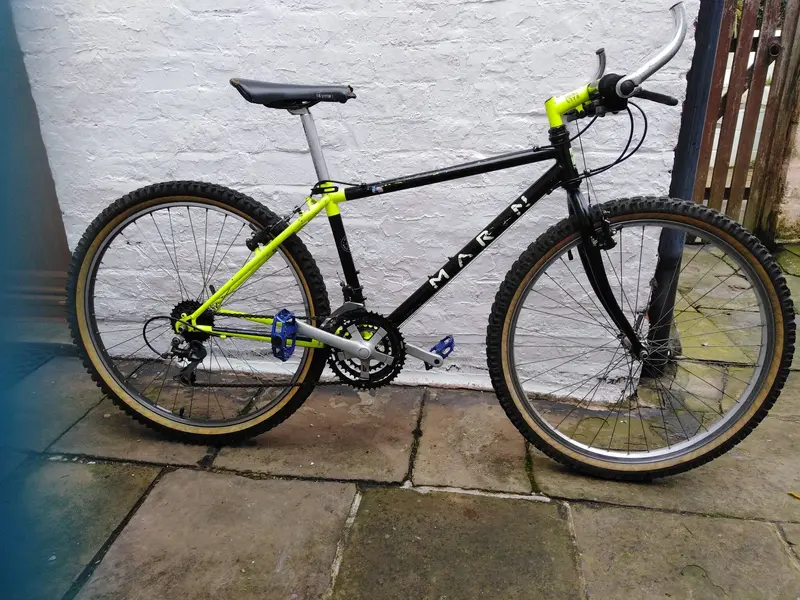

Yesterday I had some spare time, most of the day actually, meaning I could bolt some stuff on and see how it all works together.

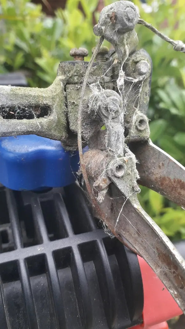

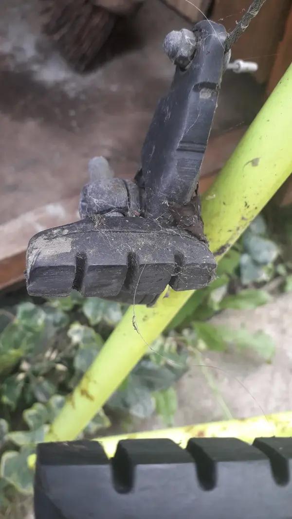

I've reused the cantis, even though one arm has its plastic shaved down where the brake block has dropped below the rim and the arm has become the 'brake'.
Old bottom bracket is out. Took so much force to rotate it that the bb tool has ovalised! Never seen that before.
Stuff has been installed but I'm un happy with the gearing. New cassette, nearly new chain just dont get on with the shonky freehub and malfunction of the 020 shifters. It's just not meshing.
I can just about live with the tired rear wheel, for this side of 2021 anyway, but I have some gripshift that will do the job nicely. Also the DX has play in the lowest pivot (couldn't detect before fitting up) so I will monitor that for now.
The amount of mileage anticipated means I will swap stuff out as I'm going along rather that throw good parts at it that mat not suit in the end.
'Love me and my faults'.
I still cant decide on whether or not to decal over the major paint scrapes or just enjoy the honest wear of it. As a build goes on, your standard seems to ascend also...we'll see.

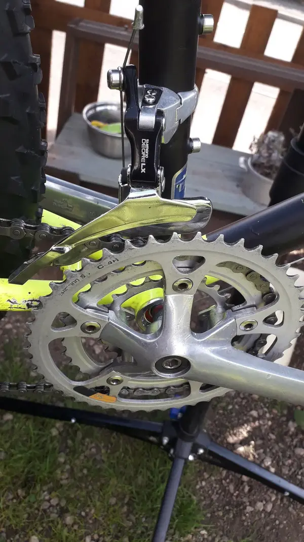

As long as you keep the black and yellow paint as eye catching as possible, you wont fail. The low end groupset is easy to replace with much better items. Say LX, dx, etc..
Hubs can be a challenge as exage wore oit quick if not meticulously maintained.
is that the same front mech :eek:Sterling work so far! love it
I'll be honest, I bought a lx550 off ebay. It works as well as it looks. The 200gs got binned along with the chainset, bottom bracket and finally shifters (today).
