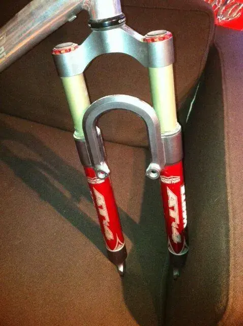

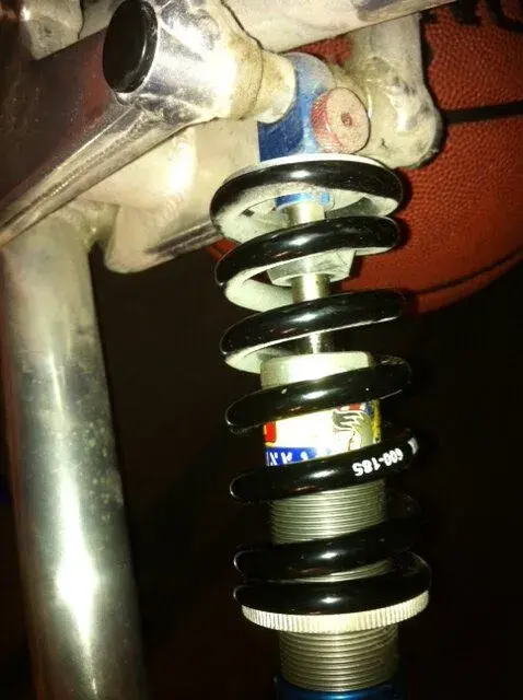

here are the pictures
Needs a good clean!

And I reckon if you cant find canti studs you should sell the forks to me :lol:

Check the whole thing for hairline cracks before going any further.

Give the swingarm a REALLY good clean and check thoroughly for cracks, the MK1 versions like yours were succeptable to cracks in various locations, so much so that Marin offered no quibble warranty replacements with an upgrade to the MK2 version when it became available mid 97
Thanks guys the frame has been in my attic for12 years & the forks i got in y2k shipped over from collarado usa i still have the box & bill they have never been on the bike.
