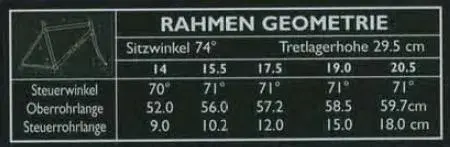

Anybody know anything of the geometry for mid nineties marins? In particular i'm looking for the headtube length on a '95 Bear Valley. Ta

I could go measure up a 1995 Bear Valley SE, probably going to be in the region of 18/19" Marin measurements (CtC) though i'm not actually sure.
Still as it was originally bar some inner tubes :)
EDIT though form the 95 catalouge
Marin Bear Valley
Best guess translation (and then put in to bike term)
Sitzwinkel = Seat angle
Steuerwinkel = Head angle
Oberrohrlange = Top tube length
Steuerrohrlange = Steerer tube length
Tretlagerhohe = Bottom bracket height

in 1995 it was 120cm long, so assume you're using ahead even though it was still threaded even in 1995, you should be able to get away with the 185 if you use a different headset and 35/40mm stem stack.
185mm-40mm-120mm+3mm, gives you a 28mm stack height to play with.
